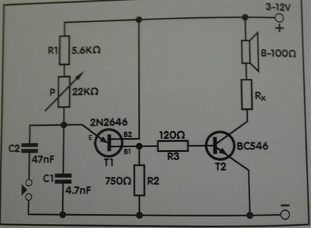

    I have a schematic that produces the higher frequency sounds ideal for dispersal of rodents, mosquito's or other animals just do not come any closer devices

    i will send a sch to do and change the capacitor to set right value to your frequency to block out mosquitos
