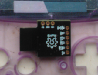

These semi-random inputs led to hillarious moments, which i want to recreate (sort of) by using an old Gameboy Color and a Digispark.
The idea is that the Digispark (which is a tiny Arduino-like microcontroller) enters random key inputs into the Gameboy, so it plays the game for itself.
When i started this project, i soon ran into some problems that i can't solve myself:
1. The schematics:
I generally know how to do it, but when it comes to really doing it, i fail. My Digispark can deliver 5V on each pin, when i measured the voltage on each button
i got about 3.4V. The output of the Digispark can be regulated, but i am sure that i need some resistors in my project. Any ideas?
2. Not enough pins
Here is a 3D render of a Digispark.
As you can see, it has 6 pins. But the project requires 7 output sources. This could probably be done by creating a matrix, but again my knowledge is not advanced enough. Can someone give me a hint?
I would be really thankful for any kind of response. I don't want to accidentally trash my Gameboy, that's why i created this post.

    e14 Contributor over 12 years ago in reply to herrlichakafool
    I'm the creator of the Digispark - to clear up a few things:
    The Digispark is an ATTINY development board it uses the Attiny85 microcontroller and allows it to be programmed over USB with the Arduino IDE
    The Trinket made by Adafruit - which is what Noah posted a photo of - is exactly the same hardware - Adafruit released this version after the Digispark's success. The Digispark has a much bigger user community behind it at digistump.com/board
    The Digispark you have pictured is a counterfiet clone - you can tell because it does not have our web address "digistump.com" on the back. Most of these don't work or fail quickly due to improper parts (mostly the zener diodes and protection diode). If you'd like to get the real thing go to digistump.com - we also support all users of real digisparks through our wiki at digistump.com/wiki and our forums at digistump.com/board
    You may be able to do something like this to get two outputs from one pin: Batsocks - Controlling Two LEDs per uC pin
    We also sell a expander kit that adds 8 more outputs to the Digispark
    To get your 5v outputs to 3.5v you could use a resistor divider (voltage divider), you could put a 3.5v zener diode from that pin to ground, or you could use a level shifter chip.
    Hope that helps direct you down the right path.

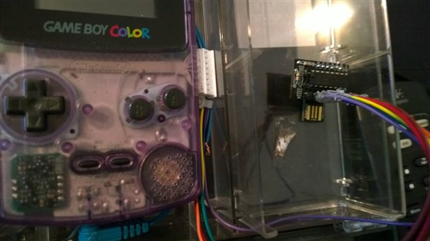

  • herrlichakafool
    herrlichakafool over 11 years ago
    Hey,
    it took some time for me to update my project, but here we go:
    I soldered really thin wire to some testing points on the board of the gameboy for following pins, with their randromized chance to be pressed in brackets:
    1. Ground image
    2. Up (25/200)
    3. Down (25/200)
    4. Left (25/200)
    5. Right (25/200)
    6. A (50/200)
    7. B (40/200
    8. Start (10/200)
    He runs like a charm, with the Digispark hanging on an USB source and the Gameboy on a 3V 200mA power brick.
    Now again, any tips how to run both on one source? I have plenty of spare power bricks with differentvoltages, so any tip would help.
    Besides, i want to add some type of lightsource, maybe a LED strip. Also if you want to know, he is still at the first town and can't make it to the second town and he has a level 43 Bulbasaur,so he didn't evolve image
    In addition, i want to add some sort if input to control the chances of a button to be pressed, maybe some Potentiometers? I imagine them to be placed in between Gameboy and micro controller, so it can read the resistance.
    Are the pins capable to pull this off?
    Would like to get some feedback from you, i'll keep you up to date.

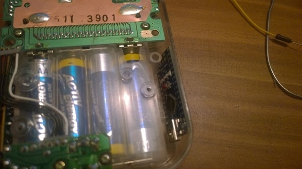

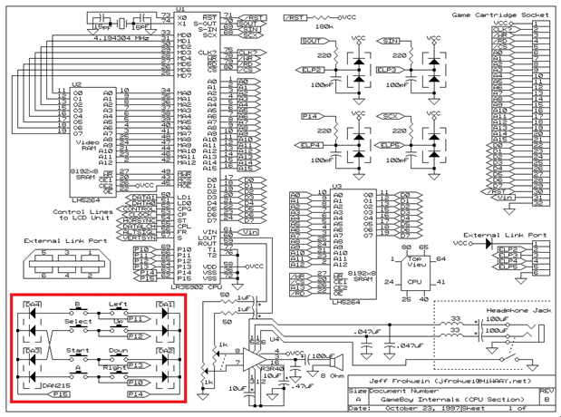

    Hey,
    after some time i started to get back to my old project, but this time using a Gameboy Classic, since it would fit perfectly into the box i posted above.
    But quickly after starting i ran into a problem.
    It seems like the old Gameboy Classic uses a more complex circuit when it comes to button inputs, as you can see here:
    In my first attempt i just connected both grounds of the Digispark and the Gameboy Color, and i wired each button i needed to a digital pin.
    Unfortunately this does not work on the classical Gameboy.
    I still have problems with the power management, but since the Gameboy Classic uses 4 AA batteries, it would come closer to the 5V needed for the Digispark.
    Luckily i found a spot where an Arduino Micro would fit inside, so it can be one unit insdead of the ugly workaround i used on my first attempt.
    So, if anyone could help me on this project i would be very thankful.
