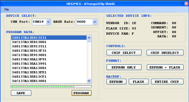

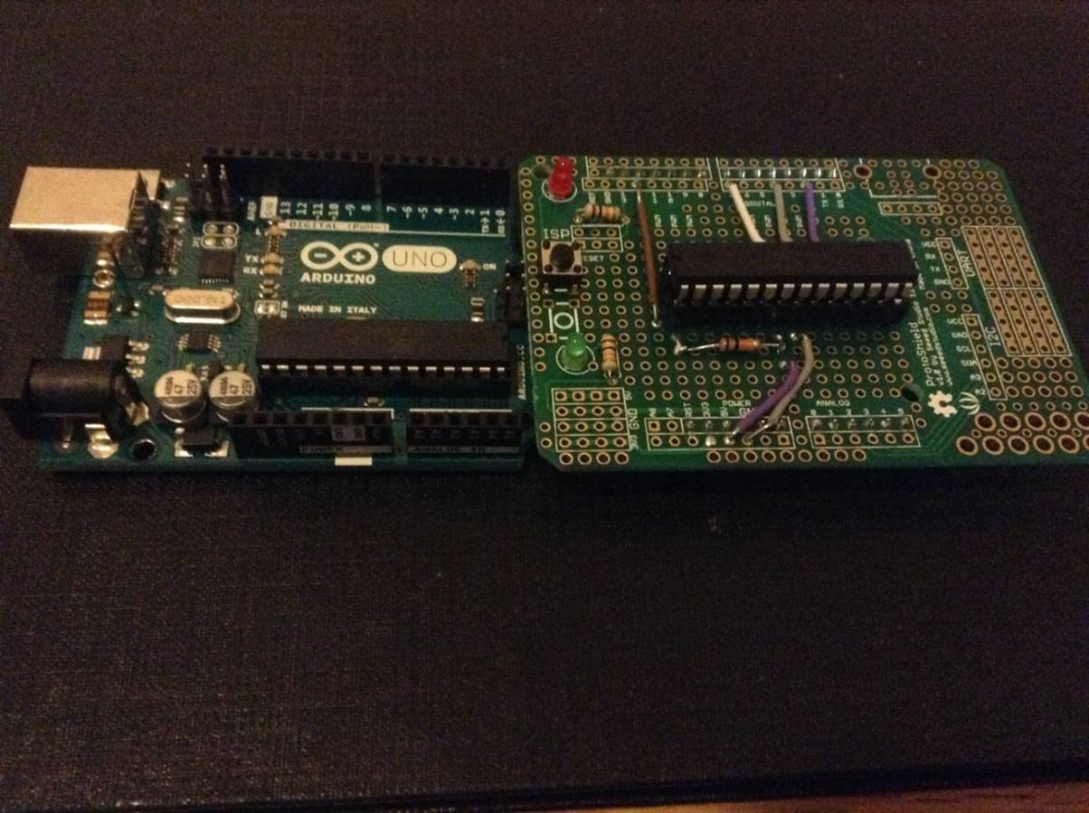

    I was thinking of creating an easier method of MCU programming so made an ATmega328p Shield for Arduino Uno. After placing the MCU in the shield,
    people can plug in their Arduino Uno, open the HEX2MCU software I created and select a program and bootloader hex file that convert over to Arduino Sketch Firmware Commands telling the data where to go on teh MCU. I also gave it an option to make binary images of the EEPROM and FLash..
  • iexpress
    iexpress over 11 years ago
    Here's a demo video of the HEX2MCU software I created to program the ATmega328p MCU on a Shield connected to an Arduino Uno.
