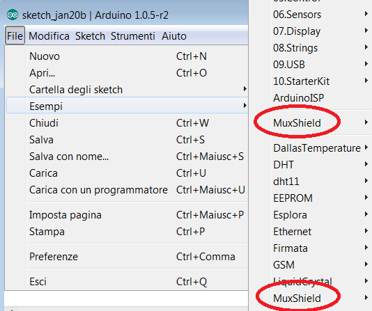

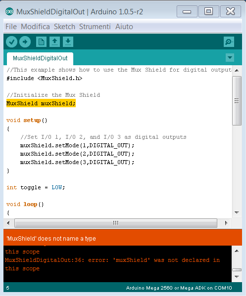

Hello everyone,
I've bought a Mux Shield II and I'm trying to test it on an Arduino Mega 2560.
I've downloaded the libary and put in libraries folder just exactly how it's explained into User Guide,
The error is in the initializing  of the shield:
How you can see from the image, the shield is not even recognized as type of variable.

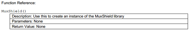

In userGuide I can find:
I've also tried to implement:
MuxShield() muxShield;
using the parentesys but I got the same error.

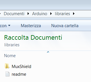

    Yes, I have, and after th error, I've put the library there also.
    The double directory is due to the presence of the library in both Programs>Arduino>librariers and also into Documents>Arduino>libraries.
    But this ad I've done only after the error (restarting the IDE) many and many times...

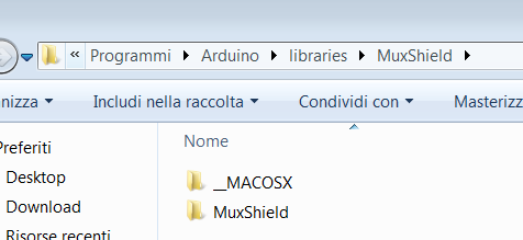

    Thank you all guys,
    I removed the double library folder and just put it into Programs> Aduino>libraries
    Then I REMOVED THE FOLDER "_MACOSX"....
    So from:
         Programs> Aduino>libraries>MuxShield>_MACOSX
                                                                      MuxShield
    It got:
    Now the sketch works... Thank you very much all!
