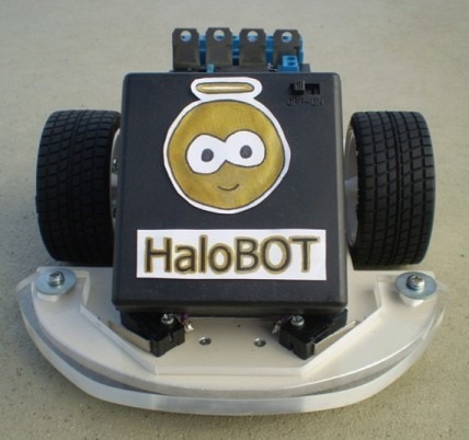

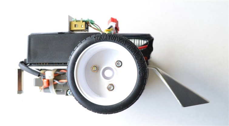

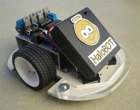

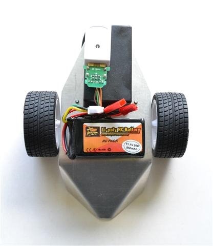

    mcb1 over 11 years ago
    Dimitrios
    Nice project.
    The ping sensor may not be seeing the echo from the door, and as I understand not all ping sensors are equal.
    To overcome the front wheel issues, I've tended to build tail draggers (ie the third wheel is at the rear).
    It tends to stop doing wheelstands, if it gets slightly stuck, and helps with turning.
    I haven't tried the ping type avoidance but have used a solid bumper with microswitches on one.
    This used a tamiya ball castor for the third wheel, and is picaxe18 based using the high power control board (pre my Arduino days image )
    This 300g bot used a rounded off plastic screw, and uses a Wireless Nintendo Wii Nunchuk remote control.
    The Tamiya sports wheel used in both these are 55mm diameter.
