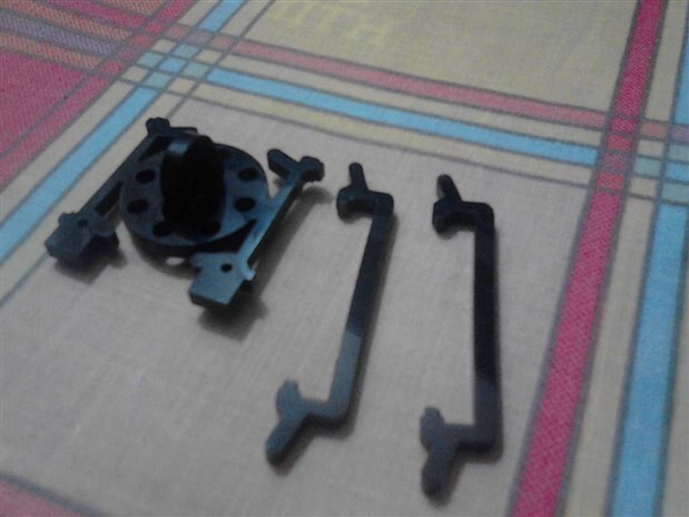

The kit of the robot is from Actobitty and it is a simple 2 motor with an aluminum chassis.

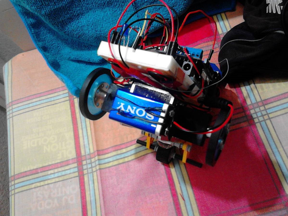

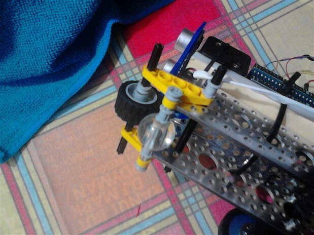

The front "wheel" was a simple plastic one and i noticed that it was difficult to overcame small objects and also difficult in turning. So i took pieces from an old Lego Technic and i made a front fork.
this was the front wheel and these are the holders of the battery below the chassis. I also removed them and manage to transfer the battery up.
this is the Lego fork
this is how the robot looked when i assembled it.
and this is how it looks now.
The original kit includes two holders for your Arduino or Raspberry. I manage to put the breadboard with the holders.
Also the battery pack moved in front of the micro controllers.Now there is a small space at the end of the breadboard for connecting leds etc.

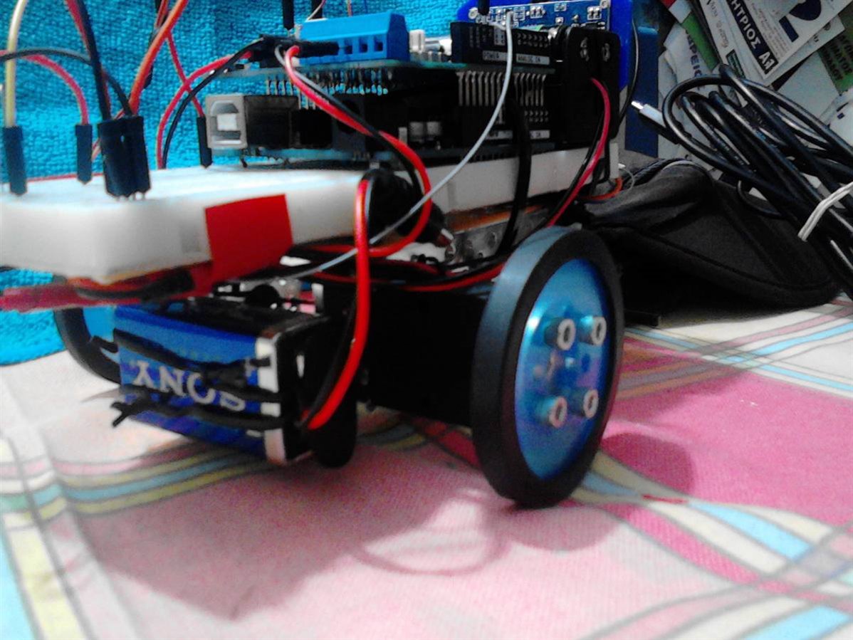

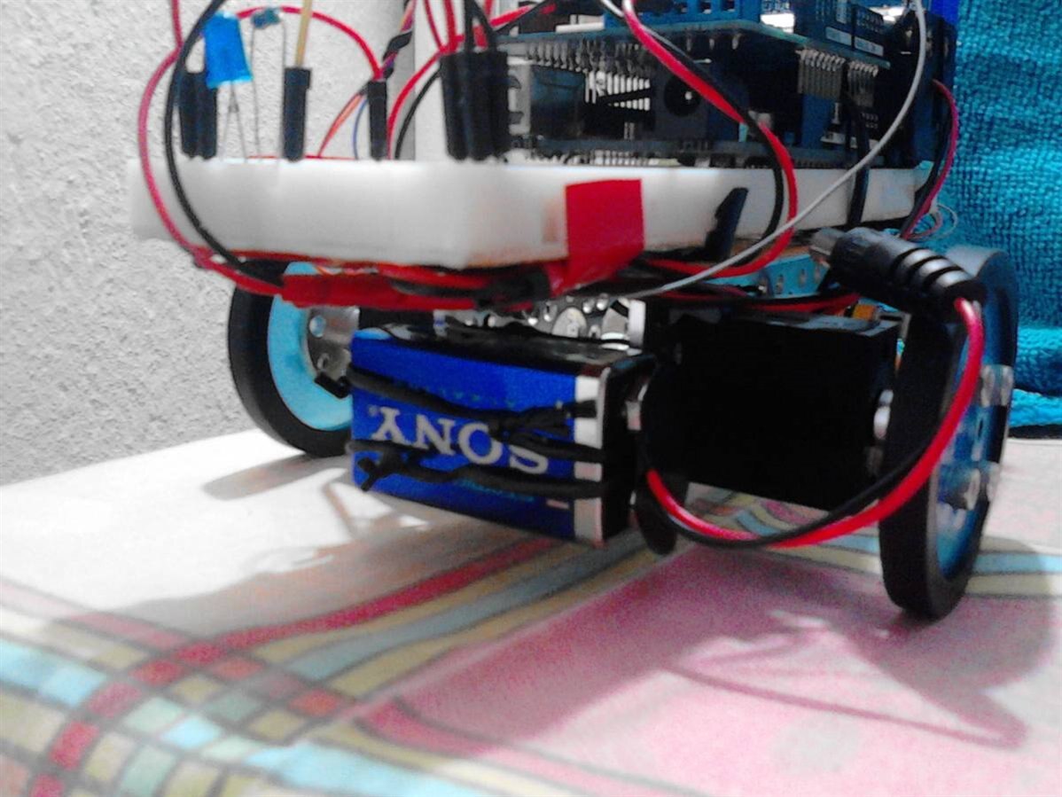

    A small modification to the 9V battery. It stays at the back of the chassis with tie zips. The good about the Actobity chassis is that it has a lot of holes and you can attach either sensors or whatever…

    As u can see i added the 9V battery because it draws a lot power. if u try this only with the 9V or the pack of 4 AA batteries you will see that it moves slower and not correct.

    A small modification to the 9V battery. It stays at the back of the chassis with tie zips. The good about the Actobity chassis is that it has a lot of holes and you can attach either sensors or whatever u can .
