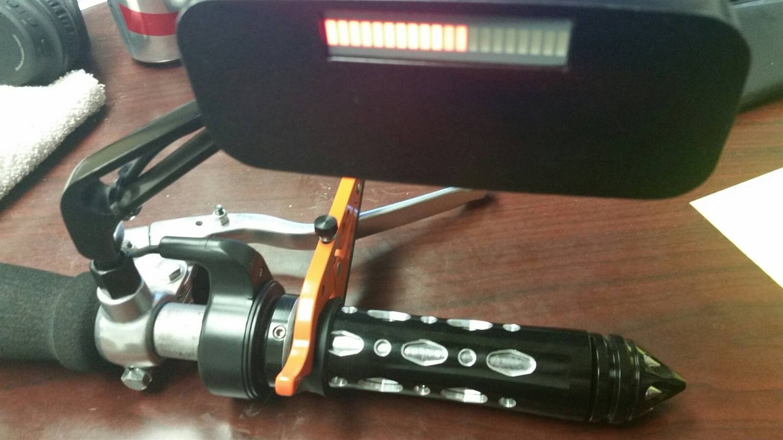

I am a machinist and manufacturer of a motorcycle throttle lock and recently purchased some boards for displays that read a pot from an electric bicycle throttle and use that information to light up a series of LEDs that are mounted on the board. Basically it is an RPM gauge.
Unfortunately the LEDs are very dim and I am hoping to have a few boards made that I can use to light much brighter LEDs. I know 3D design, CAM, G-Code and machining, but electronics are a foreign language to me. There are a few other design considerations and constraints but I was poking around and saw the Arduino Nano and love the small form factor since ideally this needs to fit into a small mirror housing.

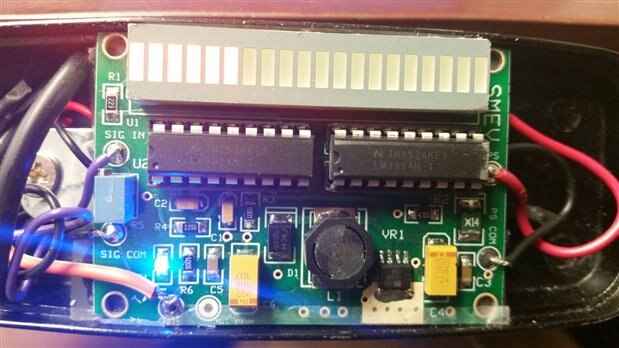

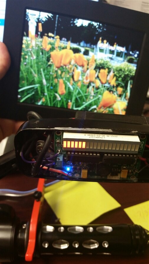

    These boards cost me $70 each which is WAY to expensive for what I need. Replacing these LEDs would seem to be a poor investment.
    Pictures attached. The board is 2.5" x 1.75" the 1.75" is perfect for this case and would be most convenient to stay equal or less than that.
    There are 20 LEDs on this board 4 of which always stay on. 10 LEDs would be plenty if only the first one stayed on. Red LEDs are perfect but I'm not really hung up on the color.
    These are point of purchase displays for dealerships. I am going to have a digital picture frame behind the display so I ideally the board would be able to share the power supply from the picture frame. the one in the picture uses a 5V___1000ma supply so 5V would be ideal, however I can try to find something else.
    I'm not stuck on the Arduino, but definitely need something better than what I have now.

    Hi Brian, it looks like you've got the bar graph chip Doug mentioned. If it is to go on a bike then I'd swap out those sockets and solder the chips directly but if it's to be office based then that's not an issue.
    To be honest $70 for a a small batch of boards is not a bad price. You will find that the costs are not due to the selection / number of components but the design and assembly time. If you have thousands to make then you should be able to get the unit cost down. I'd have thought you could swap the LED array out with high brightness LEDs, either thru hole or surface mounted to solve the light problem and reduce the part costs. If you can't change the board then you could have a daughter board built with the same pin out as those LED arrays that could be swapped in.
    The key reason to swap to a micro-controller would be if you want to experiment with different algorithms for converting the movement to lights on.
    Could you do this with a nano, possibly, alternatively a Pro Mini or similar to get a few extra pins. You might need to use transistors to drive the LEDs, the ULN2003 is cheap and commonly available. You don't actually need a whole Arduino board to do this simply start with an ATMEGA328-PU chip. However, once you start making custom PCBs and putting a few other components on and you'll likely find yourself back in the $70 mark.

    I agree with Andy, it should be straightforward to swap the LEDs out. Those arrays are a bit tricky to desolder but there are tools for that.
    There is also a single resistor (two in your case since the board has two ICs) that determines LED brightness, see the LM3914 datasheet for details, so
    there is an opportunity there to increase the brightness provided the LED display can handle it. It may be a slight improvement for near-free, just the cost of
    the resistor.
    Also, you didn't mention, but does the front panel by any chance have an optical filter? (EDIT - I see from the last photo there is no filter).
    There are red or neutral (gray) colored filters that are often used. It will add to the cost though.
    The gray ones are excellent, and can really enhance the visibility of the display. I personally don't use LED displays without a filter, it could be considered near-essential. It is a piece of plastic which can be cut and glued in place.
