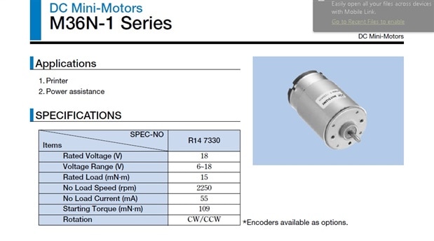

I hope this email find you well. I have question about the needed parts for practicing PWM on motor operate on 5-18 voltage. I have arduino and Motor control shield for arduino. Is these two parts enough or I need other parts.

    Sazan, the only additional thing you need is a power supply - and a motor. You'll have to provide the 5-18 volts to the controller board from separate power.

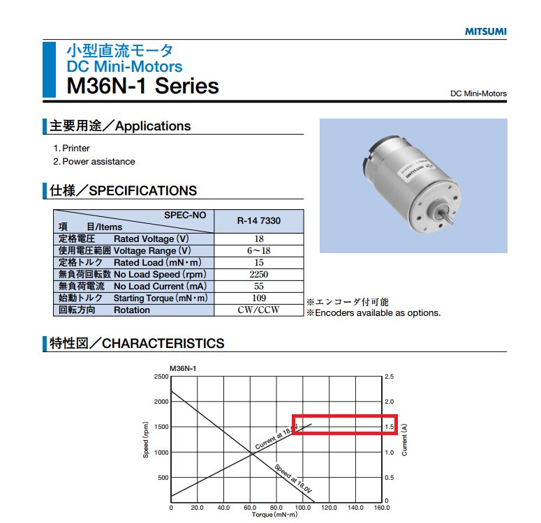

    thank you for answer
    the motor I have has the attached datasheet. Is it good to use it with ardunio? or I have to change it .
    0 Jan Cumps over 10 years ago in reply to Former Member
    From the photo of your motor shield, it seems that you have the Adafruit Motor/Stepper/Servo Shield for Arduino kit - v1.2 - or a clone.
    https://www.adafruit.com/products/81
    They have a tutorial: https://learn.adafruit.com/adafruit-motor-shield
    Follow the steps on the left side of that page. Start from the begin. Once you reach the 'Use It' section, follow the library install, Power Usage and Using DC motors parts of the tutorial.

    ok so the motor will not work at full power. I will connect the motor to signal generator. The motor will rotate, the ardunio connected to the computer power only. By using photo sensor I can find the rpm (speed).
