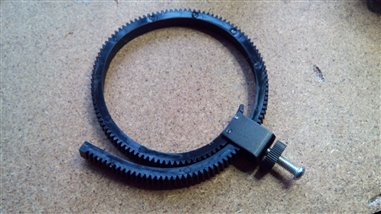

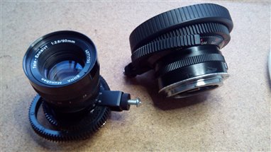

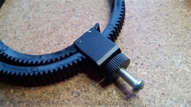

    Hi Christoph
    I know very well your problems image and in my opinion there are some details and aspects of the problem that you should consider.
    • Stepper motors you are using, not to mode the entire camera but to slide the optics to me sounds fine. They have a torque of about 1.2 Kg / cm that hopefully are sufficient. TO manage the optics, of different sizes and diameters you need to make something less rigid like the image you attach, a motor support that can be moved until touching the optic ring. In my opinion the solution your have proposed can be optimised in some parts. I suggest to take a look on how works the manual focus rings helper to have some better inspiration.

    In the following images you see how the rotating ring of manual lenses can be easily converted for few cents to a reliable geared unit that I regularly use.
    Hope this can help. Looking forward for some more details and your progress image BTW: Better for the readability if in the post you add the images inside the test instead of attaching them.
