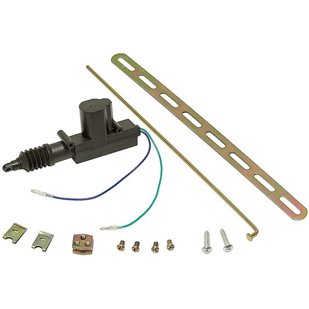

    First a locked box is a no brainer. but you will need something more than a 9v battery.
    1. Get your self an electric lock, a wall wart (power), and relay.  12-VDC-POWER-DOOR-LOCK-PUSH-PULL-SOLENOID
    and your done..

    • The relay board shown below is each relay needs a separate input. Make sure that the board is optocoupled!! So If you had 8 boxes you need 8 outputs..
    • You could use an I/O decoder 4x16 (CD54HC4514) might need level shifter
    • OR use a I2C expander ie. no level shifter required. Easy Peasy!!
    • Make sure the wart, 12vdc @ 1000w or 1Anp or greater, that can handle the current of your solenoid.
