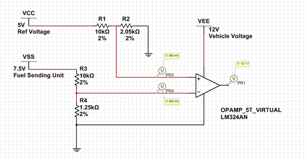

    0 e14 Contributor over 10 years ago in reply to mcb1
    Very sry to hear that Mark.
    I've done a little research on my own with using OpAmps as comparators to educate myself so that I may have a somewhat intelligent conversation with you. Here is a design I came up with, and I'd like your thoughts. Im sure i've overthought it terribly but hey it's my first OpAmp circuit. I created this using Mousers MultiSim Blue so the voltages you see are just virtual probes. I left out the voltage regulation circuit for the Ref Voltage to keep it clean and on point.
    I have yet to ascertain the actual voltage from the vehicle fuel sending unit. its difficult to get to. So tomorrow i'm going to see if I can get the reading I need from the instrument cluster itself. i'll change the
    values for the voltage divider accordingly when I get that info.

    0 D_Hersey over 10 years ago in reply to e14 Contributor
    This is a fine circuit for a beginner.  If you want a little hysteresis to avoid sending thin pulses to the pump, you can use two comparators  and a (F/F) flip/flop.  Similar to the internals of a 555.  Good job!
    0 mcb1 over 10 years ago in reply to e14 Contributor
    Thanks for the thoughts.
    After I wrote the first comment there was another IC that came to mind (but I couldn't remember the number).
    LM339 is designed as a comparator and the good news is it works from 3-32v DC, so no funny voltage dividers required.
    Your circuit is pretty close.
    A small amount of feedback to create Hysteresis will help, and something to drive the relay.
    A small capacitor across the input to damper the fluctuations.
    I have something that needs redrawing but I'm struggling to find a sender and gauge to be able to verify it.
    So it may have to be the concept rather than the final design.
    The other guage and sender will be useful. If I recall the senders are usually wirewound and not very high in resistance.
    As I drew it it seemed that the gauge was closer to being a current meter, than a voltage gauge.
