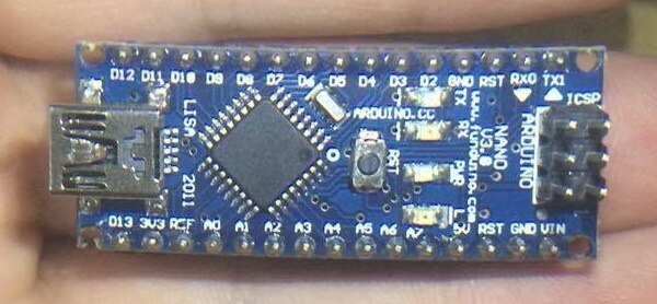

Recently I've bought an Arduino Nano and somewhat reason it won't accept my code!

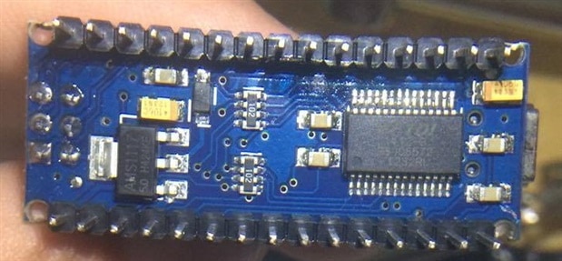

And some Photos of the device. (I couldn't spot a error on the board.)

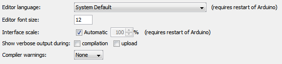

    What are the error messages in the area below the code ? You can set the IDE to give more information. Under File-Preferences you might want to set the Show verbose output during upload You need to set…
    mcb1 over 9 years ago in reply to alienozi +1
    I forgot to change that You aren't the first or last to do that one.
    0 mcb1 over 9 years ago

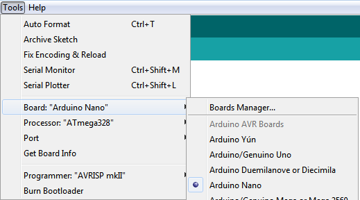

    You need to set the board
    Plus set the Comm Port.
    It might also be helpful to tell us what Operating System you're using.
    Otherwise your code compiles okay.

    0 alienozi over 9 years ago in reply to mcb1
    Oh thank you! It uploads correctly now. In my recent project I've used UNO, I forgot to change that image mcb1
