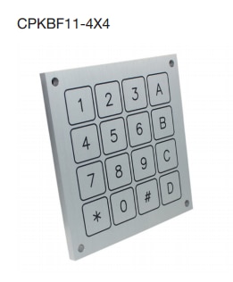

i'm starting a new project, the global idea is to enter some datas through a keypads.
the keypads need to be with a IP68
so the best keypads for my project is a piezo keypads
I don't find anything in the datasheet :  http://camdenboss.com/media/category/files/piezo_keypads.pdf
Can i use this type of keypads like any other 4x4 matrix keypads for my arduino ?
Can i use a standard keypads tutorial to connect my piezo keypads to my arduino ?
Thanks !

    Take another good look at the data sheet, it tells you most of what you need to know.
    Short answer, you can use the keypad with an Arduino as long as you are careful to make sure you do not over drive the Arduino inputs.
    The 0.2A output drive worries me as you want to keep the current into an Arduino down to 0.01 or 0.02 Amps max.
    The PDF also provides the output signals for each key pressed, so you just need to match the output pins to properly decode each key pressed.
    While robust, are you sure these keypads are the best to use?

    Aside from the fact the PDF is rather lacking in information, specifically where the 24V connects and how the output is presented to the interface
    I get the impression the output is simply a 4x3 or 4x4 switch matrix (Probably fets instead of mechanical), the same as many other membrane keypads are and if so should be able to be scanned through the existing keypad libraries for Arduinos etc.
    the 200mA is the rating of the switches, not the current being output, I would suggest that a simple pull up resistors to the supply of the scanning microcontroller would be sufficient or use the internal pullups of the microcontroller GPIO pins.
    As as the unit has such a vast supply range, simply power it from the same supply as the microcontroller.

    Looks like a standard 4x4 matrix.
    The 8 wires end up like this according to that table.
    5678
    1123A
    2456B
    3789C
    4*0#D
