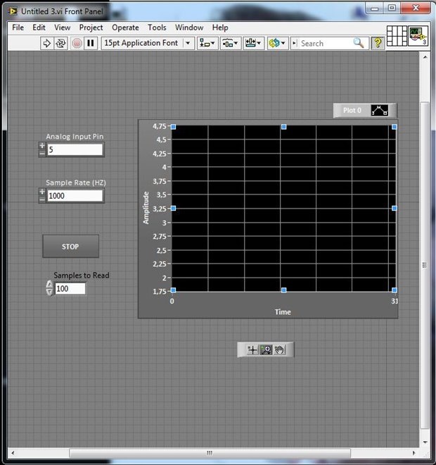

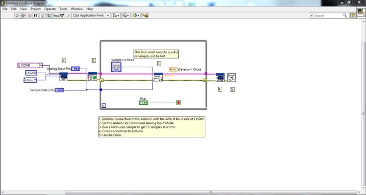

Hello everyone,
I've searched the web for about a week trying to find a solution for my problem.
As the title says I am trying to read an AC 50Hz sine wave from the analog input pins, and display it on my computer by using LabView, problem is that I can't get a normal sine wave signal, I'll upload pictures that show my sine wave, and my program (vi) in LabView. Does anyone know how to get a pure sine wave? Thank you in advance.

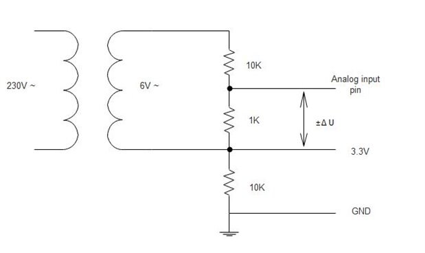

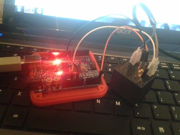

    Hello,
    I do have a transformer, it's a 230V prim, and 6V sek, 1.5VA , but I don't have a filter, my circuit is just a transformer with a voltage divider, and an arduino Uno, I'll upload a picture of my setup, and a schematic which shows resistors values. As you can see I don't have an original arduino, but so far it has worked perfectly.
    Thank you for the reply.

    That's a strange cause. Your non-original has the same microcontroller (=the same ADC) and is also xtal clocked.
    Looking at your LabVIEW screen, It looks like sampling jitter more than ADC errors (although the controller shouldn't have jitter issues with a 50-60 Hz signal).
    The xtal on your clone has to be very bad to cause this type of sample artifacts.
    The other thing that could cause this is the UART implementation on the clone, or different baud settings when switching between clone and genuine.
    You're using serial comms to exchange data with the PC. If that doesn't go fast enough, it can explain the jitter.

    I was thinking about noise too, but with the approx. 11K load between analog in and GND, the noise has to be fairly strong to impact the signal that much.
    edit: if I recall my theory well, the input impedance is less than 1K and not approx. 11K, because impedance-wise, the resistance between 3V3 and GND is close to 0 ohm. It would be good to correct me if I'm off here...
    edit 2: I'm not sure what the role is of the lower 10K resistor. It doesn't play a role in the voltage divider because it's a load between the fixed 3V3 and GND.

    The 10k resistor between a 3.3v port, and a GND port is to prevent any current flow towards the ground. The arduino that i bought was pretty cheap so that might explain my previous problem.

    Input impedance is about 1K.
    If your secondary is 6 Vac RMS, it has a peak-to-peak voltage of at least 16.97 V.
    When one side of the transformer output is connected to 3.3V, the other side fluctuates between +20.27 V and -13.67 V.
    By my calculation this means the analog input fluctuates between 1.843 V and 1.243 V.
    This is safe enough, but the total peak-to-peak voltage at the input is only 0.6  V.
    With a 10 bit A/D this gives a resolution on the signal of about 122 counts, so a 1 bit error is about a 1% quantization error.
    Accuracy is a whole other calculation. Presumably the internal voltage reference is not used since the signal is over 1 volt, so accuracy is dependent on power supply, which could have a 10% tolerance. 10% of 1.8 volts is .18 V which is about 30% of the full scale signal.
    I would not expect a clone to have significantly different performance (they use the same CPU), but it might be possible if their signal routing was circuitous or higher impedance.
    I would check to see if small changes in external wire routing cause distortion of the signal. If you touch the wires, does the signal change? I would also use a little filtering if the noise is not wanted.
