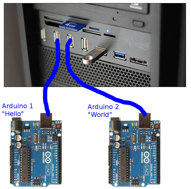

Study case : I want attach two arduino to 2 port usb, and with PC application (Java Application) i want send specific message to arduino.
through Button 1 when I click then I send "Hello" to arduino 1via usb 1, through Button 2  on java application when I click then I send "World" to arduino 2 via usb.
How is its program ? send message to specific arduino via usb ...
Thanks.

    Hi, Each Arduino UNO, will have its own serial port, i.e. Windows O.S. will assign a different COM port to each Arduino, then your java application will use both COM ports. Regards

    Hello gihu: If I want to send message to 8 Arduino devices with 1 PC, Is that also OK?The situation is same as " M Imam Alqamar" , but I would like to send message to 8 Arduino. devices. Thanks Best regard…

    Hi,

    Hello,
    Yes, it is possible do it in the same way (if your PC has not enough USB ports, a HUB may work).You could use 8 USB, and use 8 different COM ports, but maybe there are more efficient ways, depending in your application.

    Dear gihu:
    I have tried connect 8 devices together, then it is ok, Thank for your help.
