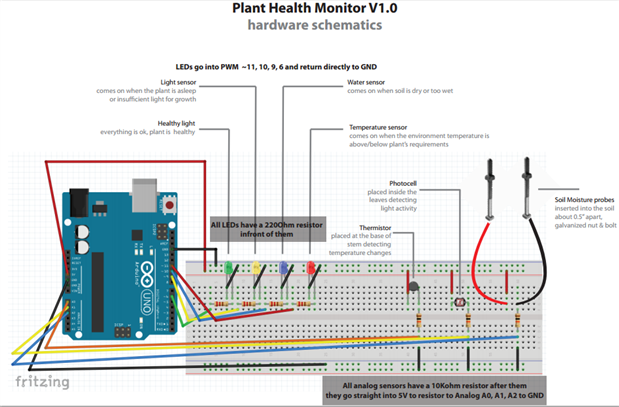

I have made an integrated arduino monitoring system with 3 sensors....
I have used leds to show their values
But i want to add a lcd to it and an ethernet shield to it..... Is it possible?
Let me tell you that I am a beginner.....
Ive attached the schematics please modify it and tell me...... Please!!!!!!
imageFA5RM0AHX1W2JT3.pdf

    Looking at your breadboard layout your analogue inputs don't look correct to me.
    Firstly it looks like you have misaligned the lower ground connection from the Arduino to the breadboard power rail in such a way that the 10k resistors are not tied to ground but just to each other.
    Secondly if the 10k resistors were tied to ground then your three analogue inputs would also all be tied to ground which would not be of much use.
    The photo resistor for example is normally set up as a potential divider circuit so your analogue input would be  taken from the midpoint between the resistor and the photo resistor as per this circuit:
    https://www.arduino.cc/en/Tutorial/AnalogInput
    • Reject Answer
  • beacon_dave
    0 beacon_dave over 9 years ago in reply to beacon_dave
    Also perhaps be aware that the power rails on some breadboards are not continuous but instead are interrupted half way along. You may find that you need to place a jumper on your ground rail between block 5 and block 6 to continue the ground rail to reach the 10k resistors. Alternatively move your ground wire from the Arduino two blocks to the right.
    The same may apply to your +5v rail at the top as it may not reach the components at the right hand side of the breadboard.

    Can u please give me a hand drawn schematic of the modified connections? Please give

    The author of the original Instructables project Plant Health Monitor appears to have updated it here:
