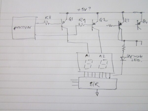

    0 jc2048 over 8 years ago in reply to tim687
    Tim Koers wrote:
    I've created a little schematic, the output pins of the shiftregister Q0-Q7 (in order) corresponds to the pins A-G and DP.
    I've also figured out which pin controls which segment, but the strange thing is that there is no correlation between the serial input and the expected serial input according to my pin to segment research.
    I got it working at some point, but only for a few numbers. (17, 21, 23, 25, 26, 27)
    Is there something I might be missing?
    Can you have a look and see what the part number of Q1 and Q2 is?
    Most likely the circuit is something like this, with Q1 and Q2 being PNP transistors:
    The 7-seg display is in two halves. The display of one digit is done first, then the other. The transistors enable whichever display is the right one for the data that has just been loaded into the shift register. If I'm right with the circuit, the processor will normally hold all the base drives high and take just one of them low to enable.
    The circuit is actually even more complicated, because the separate LEDs are driven the same way as the 7-segment LEDs and will have their turn too, probably enabled with Q3 or Q4.
    To disentangle this with an Arduino, you'd need to be reading the 4 lines of the multiplex drive so that you knew which data you were getting from the s/r.
    This is much easier with a scope because you can see the drive waveforms, see the order they go in, and see how much time you get to read the data.
  • tim687
    0 tim687 over 8 years ago in reply to jc2048
    There aren't any transistors connected to the s/r. The enable lines of the I individual segments is controlled trough a transistor that is connected to the main microcontroller.
    I'll have to check if I can get my hands on a scope I think.
    I am always open for suggestions about a good scope.
    Regarding Q0 till Q7, those are the outputs of the s/r
