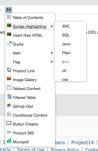

    Hello Kas,
    I have used in past (and already I have it installed on my computer) both energia (developed by TI from the original Arduino IDE) and the original Arduino IDE. Please edit your post and set the report with Syntax highlighting / Plain to make it more readable else it is almost impossible to see what happens.
    You find this features in the post edit menu as shown in the image below.
    Thank you. Enrico

    0 kas.lewis over 9 years ago in reply to balearicdynamics
    Hello Enrico,
    I would agree that the syntax highlighting helps, unfortunately in this case it's just output text from the "debugger" there is no code there at all. Thank you for the suggestion though.

    0 balearicdynamics over 9 years ago in reply to kas.lewis
    Hello Kas,
    thank you for the answer. When there is just a compilation output or similar, you can use the syntax highlighting "plan" mode. This helps a lot showing text as it is send to the terminal output. Now I have just copied and pasted your text below. The result is not 100% satisfactory as probably the E14 edito has already done its job with CSS but if you copy and paste as plain formatting I think you can get better results. It's not an option as I found very difficult to read your output.
    Enrico
