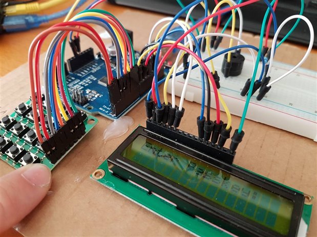

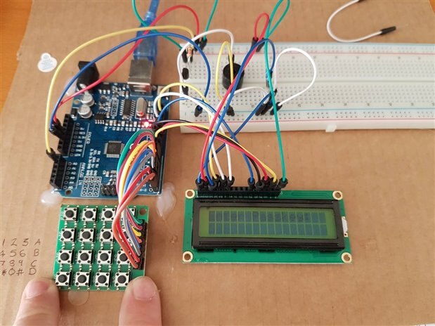

Hi, i'm new to Arduino, and I'm having a few issues with my first project.  I decided to try and recreate the Digital Code Lock project posted on Digital Digest.  I'm struggling with configuring the circuit itself.
I've successfully uploaded the code to the Uno, but there's a few issues;
-the buzzer sounds constantly.
- the LCD display doesn't power up
I've tried to lay the circuit out in a way that's straightforward to follow, but as I say, i'm pretty new to this.  I found the circuit diagram hard to follow, as some of the connections shown differed slightly with my hardware (I tried to get as close to what the original poster listed as possible), especially the keypad.  I suspect I've connected it up wrong, or put a component the wrong way round.  I've dont some fault finding with my multi meter, and power seems to be getting to the components.
I've attached some images.  Can anyone tell me firstly if it looks like I've connected it up wrong?

    Fevvahz wrote: -the buzzer sounds constantly. It looks from the pictures that you may have 3.3V permanently applied over the buzzer. If you follow the connection of the 3V3 and GND signals from the Arduino…

    Well the beer flowed, and was welcome.  Now, its time to conclude my tale....
    Firstly, I had the jumpers from outputs 8,9,10 and 11 on the Arduino to the pins 12, 13, 14 and 15 respectively, instead of 11,12,13 and 14 that it should have been - that slight misalignment really messed up the functionality of the LCD screen.  Once I'd checked again, and again, and again I finally found such a silly mistake.
    Secondly, pin 16 on the LCD should have gone to the +'ve, but I'd put it in the middle of the positive 'side' of the breadboard, but not provided any power to it.
    Thirdly, pin 3 on the LCD should have gone to the +'ve side of the 1k resistor.
    I also had the keypad rotated the wrong way too.
    It was really down to my poor reading of the diagram, but after a lot of reading, especially regarding the LCD pinouts, I finally got there.  Here's a couple of pictures of the finished setup, all working;
