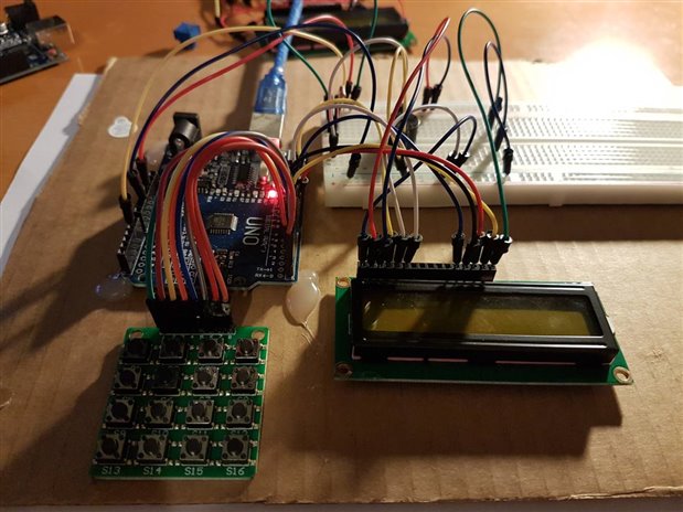

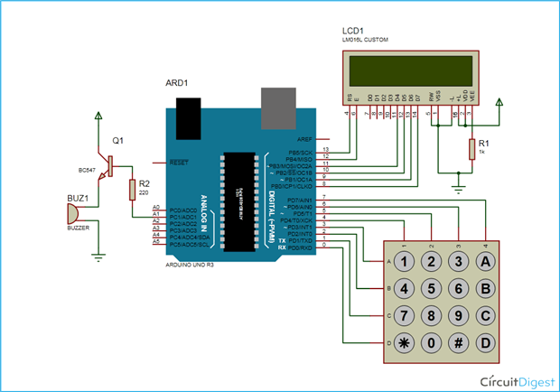

Hi, i'm new to Arduino, and I'm having a few issues with my first project.  I decided to try and recreate the Digital Code Lock project posted on Digital Digest.  I'm struggling with configuring the circuit itself.
I've successfully uploaded the code to the Uno, but there's a few issues;
-the buzzer sounds constantly.
- the LCD display doesn't power up
I've tried to lay the circuit out in a way that's straightforward to follow, but as I say, i'm pretty new to this.  I found the circuit diagram hard to follow, as some of the connections shown differed slightly with my hardware (I tried to get as close to what the original poster listed as possible), especially the keypad.  I suspect I've connected it up wrong, or put a component the wrong way round.  I've dont some fault finding with my multi meter, and power seems to be getting to the components.
I've attached some images.  Can anyone tell me firstly if it looks like I've connected it up wrong?

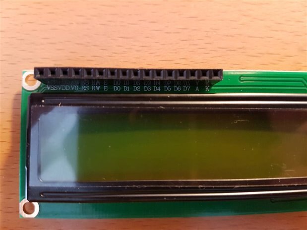

    It looks from the pictures that you may have 3.3V permanently applied over the buzzer. If you follow the connection of the 3V3 and GND signals from the Arduino to your prototype board you will see that you then have a link from GND to one side of the buzzer and from 3V3 to the other side of the buzzer so it will always be on.

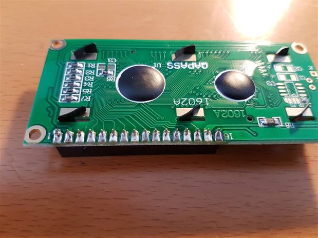

    I can only see the display side of the connections but it looks like you are just holding the wires in place with hot glue. I suspect you don't have good electrical connections here so it's not working. Either solder the wires into the board directly or solder in a 0.1" socket strip into it do you can plug into it like you do the Arduino or the prototype board.
    I've not gone through the connections in detail to see if they are in the right places.

    0 Fevvahz over 9 years ago in reply to rachaelp
    Rachael,  thanks for getting back to me.  Thanks for pointing that out about the buzzer, i added an extra wire to the 3.3V for some reason, I think the power needs to have come via the transistor.  To be honest I think its that part of the circuit that I need to look at again.

    Hi Fevvahz
    I'd go back over your wiring for the transistor/buzzer section of the circuit. The schematic shows the base of the transistor being connected to pin A1 of the Arduino through a resistor. I cannot see that connection on your photos, nor can I see a resistor.
    As rachaelp has already pointed out, the buzzer seems to be permanently wired to the 3.3V supply, completely bypassing the transistors. And as she also stated, you probably aren't getting a suitable connection from the glue on the LCD header.
    Also check the configuration of the wiring around the resistor for your LCD. It looks like you might have interpreted a join at the resistor/VEE junction which is actually not connected to VDD (No dot).
    Take a look at these suggestions and get back to us with your findings. image
    Paul

    0 Fevvahz over 9 years ago in reply to gadget.iom
    Paul - thanks for your reply.  I did wonder about that resistor, it shows a 220 ohm on the diagram doesn't it?  I'll take another look at it and see how I get on once I've soldered on some 0.1 headers to the LCD screen.  Thanks again!

    So thanks to your guidance, I ordered some female 0.1 headers, 220 ohm resistors, and took another look at the wiring diagram.  I also tested the LCD display using a spare Uno I now have, using the adafruit tutorial here and can confirm that it does indeed work.  After a little soldering, I think I'm nearly there.
    The problem I have at the moment is that the LCD display doesn't display text at all, but it does light up its backlight for a second or so.  I had previously successfully  the sketch, and it appears that the keypad etc is working.  If I type in four digits, the buzzer sounds, as if its an incorrect code, and the LCD backlight lights up breifly, but still no text.
    So in the adafruit tutorial I used a variable resistor, which I used to adjust until the LCD displayed correctly.  Do you think that this could be the issue causing the screen not to work?
