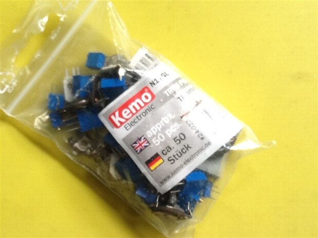

    I agree with all the comments so far. Some things could be tweaked (like amount of solder, amount of heat, maybe even the component leads could be heavily oxidised if they are from ebay) but in general it is not bad. I'm sure I've done worse, depending on what tools and resources I have. Most of the non-specialist retailers often only sell thick solder and components that sometimes look several decades old (see exhibit A-->):
