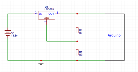

I have a transformer 13.8v DC.
I also have arduino nano. According to the spec, arduino can be powered from 7-12v.

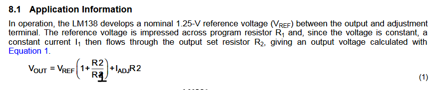

I thought using http://www.ti.com/lit/ds/symlink/lm338.pdf in-order to step down the voltage to around 12v.

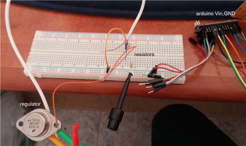

I have used the default scheme as mentioned in the datasheet
R1 is 1Kohm, R2 is 1Mohm.
  • When Vout is un-connected to arduino - If I sample Vout using a multi-meter I get 12.19v which is great!
  • When I connect Vout to arduino's Vin port - the voltage drops down and continuously changes between 8.5v and 9.2v.
  • I want to mention the circuit is not getting hot, not the arduino and not the regulator
If I understand lm338k functionality, it supposed to provide a stable voltage even with load connected.
Even though ~9v is valid for powering arduino, I don't understand the phenomena.
Someone have an idea what I am doing wrong?
How can I continue the debug?

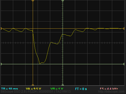

I have just received The specified item was not found.
It has an osciliscope of up to 12v (Good enough for this task)
I put the measurment on Vout of the circuit above.
I have catched a trigger (8v fall edge) when I put higher load (I provde a pulse for enabling a DC motor driver) in parallel to the arduino.
You can see the voltage it pushed from 9.5v to 6.5v during the DC activation (Higher load is attached)
When aduino is reaching towards 6.9v it then power down and the motor stops.
The signal comming back to 9.5v is because both arduino and DC motor are offline since the arduino cannot contorl over the DC anymore...
Vout on the circuit is connected to Vin of arduino.
I then put big capacitor between the 5v voltage reference of the arduino (Regulated power supply) and GND.
This keeps ardunio on 5v during this hickup.
Thanks!

    Hi Idan, The behaviour of Vout with your original set up, I'm not sure if the choice of the values for R1 and R2 @ Vout=12V were correct. From the formula, setting R1 to 100K you get I1=12uA, as you correctly…

    Provide a schematic showing all the connections you making, also is anything getting warm when you are powering the arduino ?

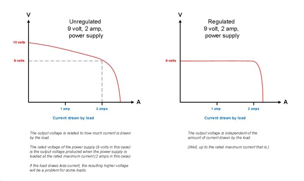

    Hi Idan,
    My assumption is perhaps overly simplified. Unregulated power supply typically is designed for "matching" loads, where you know what voltage and current the load will need (within known tolerance). This "matching" is needed, as unregulated power supply output voltage is affected both by the input voltage variation and varying load conditions. Therefore, to simplify, I used the nominal values for voltage and current to calculate a nominal power of the wall-wart. With unregulated supply, the current rating you find on the label is indeed the max output current (independently from the output voltage), but the nominal output voltage 7.5V does give you the voltage rating for your load, thus I wrote the nominal power is 2.25W. This does not mean that 7.5V are only guaranteed at @ 300mA, but the values written on the label do give you an indication on what to expect. What I was suggesting is that, using a purely resistive load, you can test this condition by "forcing" the wall-wart to give the load its max current, and the 25ohm resistor would make sure the voltage across the load is matching the nominal output voltage. I'm not assuming a linear dependency between output voltage and current to the load, the test I was suggesting above is only a "single point" test of the supply on the V-I curve for the power supply, and in the special case of purely resistive load. In general, the dependency V-I is non linear, but can be approximated as linear for output currents from 0 up to max output current, but becomes strongly non-linear as the current grows greater than the max output current.
    If you look at the plots below, perhaps my suggestion will become clearer (this is just an example):
    I hope this explains my thinking image
