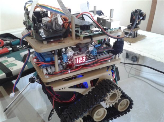

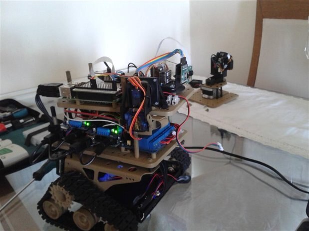

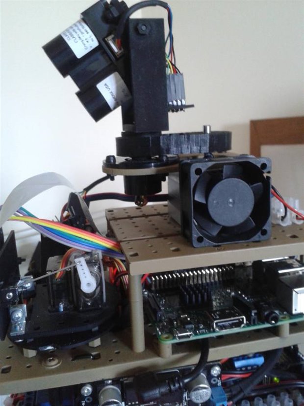

I've recently added a 3d LIDAR scanner to my robot ( Credit to these guys on youtube here they've done a fantastic job https://www.youtube.com/watch?v=gCpCGkwwy8I )   and now that ive started working with Stepper motors a lot more closely ive soon discovered that these things run HOT!  So ive been working on implementing some forced induction cooling image   Taking power from the starboard mounted DROK digital buck converter ive cabled a 12v fan in via the 4x solid state relay mounted on the front deck. this is controlled by the aft mounted arduino UNO that's dedicated for the "Science Platform" on the top deck. I have a 30x30 heat sink on coming tomorrow that i hope i can mount between the fan an the stepper to offload some heat....
So what's everyone else have their nose in!! Send in some pics
photos below..
Starboard mounted DROK digital buck converter
4x Relay at front - you can see the LIDAR unit and fan in the background

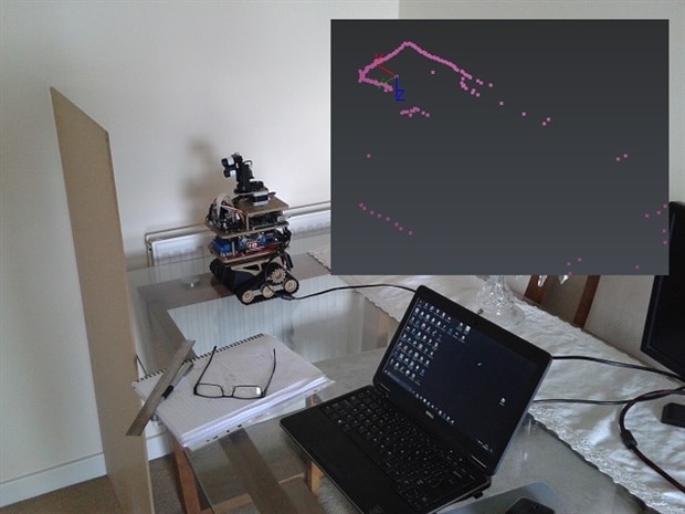

Lisdar Scanning in action - first 2D scan with the "science shelf" in full action
Have a good afternoon folks!

    Job jobbed!
    Need to look at some better mounting for the module though, something metal to dissipate the heat a bit better
    Could also look at a temp sensor to control the fan such as this one from Element 14    Anything to save power!

    Upgrade was a success, even with the temp mini heatsinks in place, with the fan on its been running 5 minutes now and i can still hold my finger to the servo

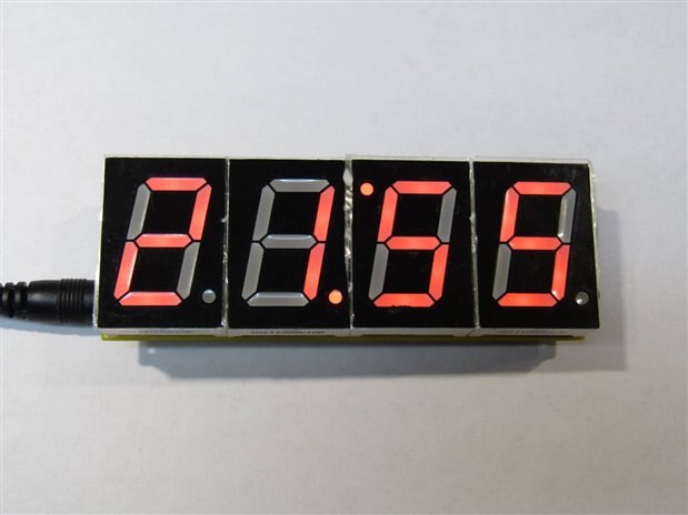

    Here is the clock kit that you asked about:
    https://www.banggood.com/DIY-4-Digit-LED-Electronic-Clock-Kit-Temperature-Light-Control-Version-p-972289.html?rmmds=myorder

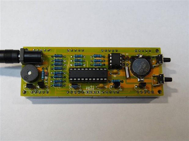

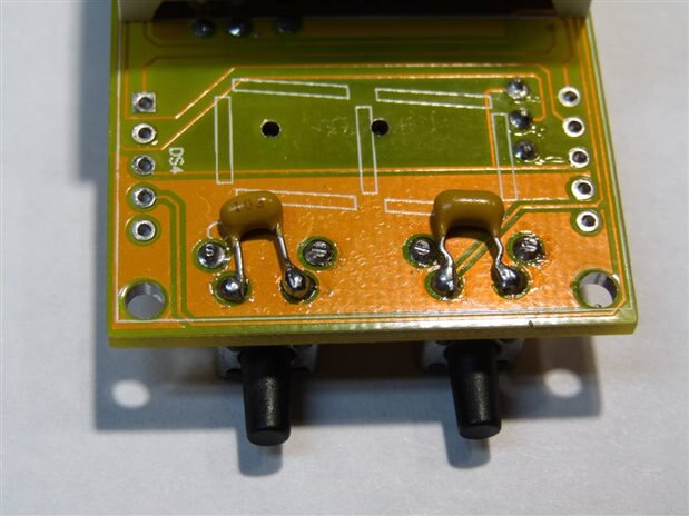

    I was experimenting with different clocks to see how they could be modified to be used in some of the makeshift test equipment I like to build from time to time. Here are a couple pictures of the completed clock.

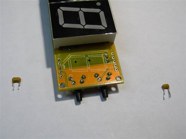

    After building it I thought I was having some trouble with Key Bounce and since I had just read a nice post about key debounce circuits:
    https://www.element14.com/community/community/project14/diytestequipment/blog/2017/08/12/vintage-555-a-general-purpose-button-debouncer
    by: balearicdynamics
    I decided to add a little extra debounce to the circuit. I pulled one of the digits back off the board so I could get at the switches.
    Then I added the two 10 nF caps across the switches.
    The bounce problem was probably just my imagination as I can't believe that the programmer of the micro processor didn't debounce the switches with software but now we have made sure.
    The construction of the circuit went very well and the unit worked though I had a bit of difficulty understanding a function on the clock that the Chinese author of the instructions called Now Time. Turns out he was referring to a feature where the clock beeps on the hours between two specified time limits.

    Why did not solder the caps to the opposite side ? It seems that now the last digit is a couple of mm hight than the others. Or it is a optical illusion?

    Hi Enrico,
    The structure of the support brackets of the switches themselves prohibited mounting on the switch side of the board. Fortunately the Display segments sit up on legs that provide 4 or 5 mm of clearance underneath. The small ceramic 10 nF fit nicely under the display and the fronts of the displays are flush with each other. Thanks again for your great post and I see that the in depth discussion of bounce it continuing over there. Awesome!

    not always is easy to understand from the images image
    BTW, respect the Chinese designers, I don't like so much components hidden under other components ...
