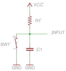

As I had to add a button debouncer to a test project based on Arduino 101 I decided to make something as much general as possible, easy to adapt to almost any micro controller and possibly platform independent. I figured two possible approaches: RC (resistor-capacitor) method and IC method. The RC option is easier to realise but I am not so confident it can be applied to very different operating conditions (e.g. very different micro controllers types and clock speed). It is not so difficult to calculate the values of resistor and capacitor for a RC debouncing circuit but I see a limitation restricting the application range. The calculation of the RC circuit is  dependent on the voltage of the board used; this means that for different voltage boards (1.8V, 3.3V, 5V etc.) we should provide a different RC calculation.
The RC simple circuit shown in the image below can be calculated with the nice RC Debounce online calculator
The parameters involved in the calculation are:
  • Voltage
  • High logic level
  • Bounce time (ms)
  • Capacitor value
  • Resistor value

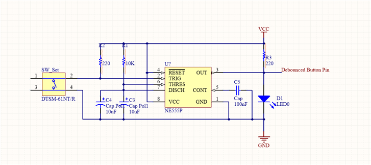

The NE555 circuit
I designed the circuit based on the popular NE555 monostable configuration shown above and detailed in the below schematics:
In this specific case using the two 10uF capacitors connected in parallel to the discharge pin and the 10K resistor for charging we get a timing of about 220 ms. It is a reasonable value to debounce a tactile switch connected to a digital input pin of an Arduino board; changing the values of the capacitors and the resistor we can increase or reduce the charge time resulting a different timing to the output pin (debounced signal.
Wiring the circuit
Using the NE555-P IC the circuit can be powered by the Arduino itself; the images below show the circuit placed as part of the Arduino 101 project where a push button is needed. The small board can also host the designated button making a compact object independent by the platform (an external power source can also be used) involving only the debounced signal connected to the desired GPIO micro controller pin.
The resulting PCB is about 30x35 mm; I have provided a tactile switch button surface mounted on the opposite side of the components to make easier assembling the module in any project.

    I agree. I just wanted to point out that the Debouncer datasheet shows the circuit diagram and it can even be built by the internal components manually (Or even external discreet components, but this would…
