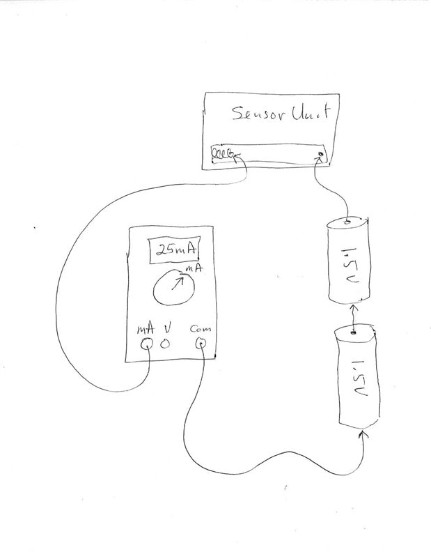

    I don't want to ask to much but can you draw me a simple schematic of that ?
    I'm not 100% sure I understand with text, drawing is always better.

    0 jw0752 over 9 years ago in reply to redgreenblue
    Hi Redgreenblue,
    I think you said that the sensor units use 2 batteries and that at least one sensor will work from the Arduino 3.3 volt supply. This establishes that they are 3 volt units and will work on a supply that is limited to 150 mA of less. I am not sure where you got the 500 mA information that you provided but I am going to ignore it and assume that the sensors actually draw a lower current level. Here is a drawing of how you would measure the actual current draw of the sensors. If this isn't the drawing you were looking for let me know as I wasn't clear what you wanted a drawing of.

    0 redgreenblue over 9 years ago
    perfect !!!!! image
    All details are on the drawing I can't ask for more !
    Hey John, it worked, I'm happy to have discover something very usefull, the only thing is that I don't have mA option on my multimeter (not sure on drawing if this is what you meant),
    so I put it to 10A which was anyway the only one I got a reading.
    It gave me 0.01, so does this mean I need to X10 times becuz it was on 10A selection...
    in other words it might be 0.100 mA if this is the right way to do this... ?
    0 dougw over 9 years ago in reply to redgreenblue
    .01 would be .01 A or 10mA on the 10A scale.
    You also need to measure when the door is open and alarm is active.
