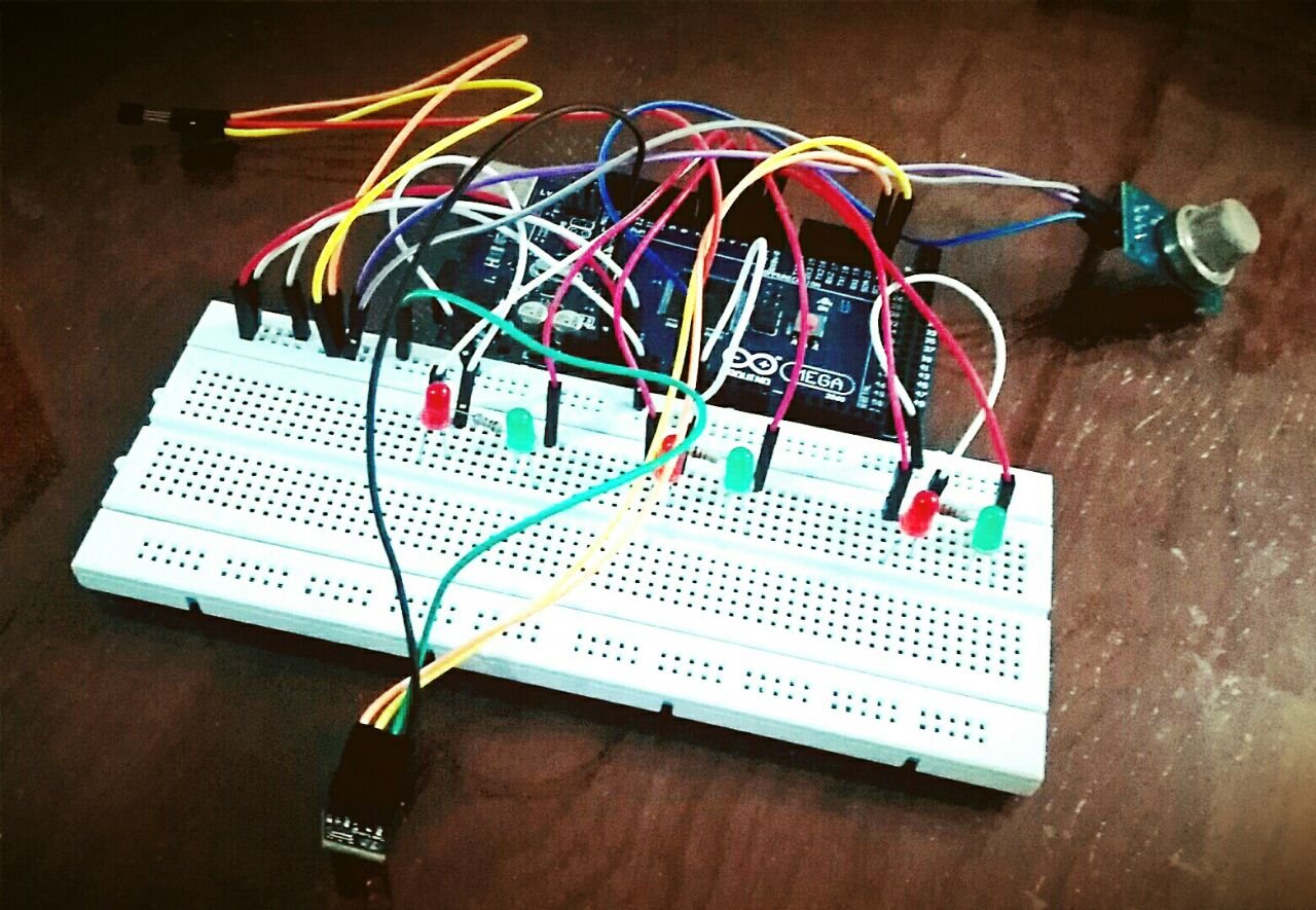

Hello everyone.
I'm new to the Arduino world and I need some help.
I've created my very first simple Arduino project [have a look]
It's really simple
It's using three sensors
1- MQ-5 for humidity sensing
2- LM35 for temperature sensing
3- BMP180 for pressure sensing
Let me explain the basic idea behind this project, every sensor has 2 leds, a green one and a red one, the greed led will be always on whenever the values of the sensors are in the right range
and the red led turns on when it over this range.

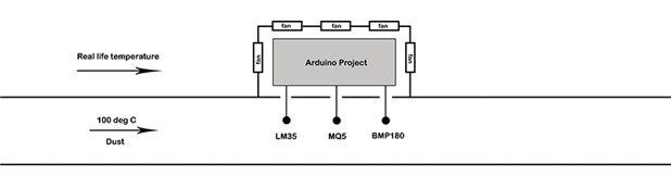

Now I want to cover this device to put it in the factory considering the following
1- It will be put in 100 degrees C
2- There will be dust
So here is what I need
1- A box to put the device in with lots of fans to keep the device cool in 100 degrees.
2- A cover for the wires to protect it from melting in 100 degrees.
3- A kind of texture to cover the LM35 and BMP180 sensors to prevent dust from going through them.
4- A kind of texture to cover the MQ-5 sensor to prevent dust but allow air to pass through.
Can you please suggest the best materials to get the job done perfectly?
Thanks!

  • zewail97
    0 zewail97 over 9 years ago in reply to the-dubster
    first, thanks for your answer.
    I hope this sketch answers your questions
    Yes, there is going to be cool air fed to the unit as shown in the image.
    Yes, the box will be located remotely above the pipe and the sensors will be placed in the environment.
  • the-dubster
    0 the-dubster over 9 years ago in reply to zewail97
    Re: Enclosure.
    There are a quite a few options available, two common types are:
    PC (Polycarbonate) temperature range around -20°C to 140°C - it also has excellent insulating properties.
    ABS (Acrylonitrile Butadiene Styrene) again goes down to -20°C but not as hight as PC - also is not as tough or UV stable.
    You could always use an Aluminium (Aluminum) case - something to be aware of, it would need physical thermal insulation from the Pipe to prevent heat conduction, also, even if not physically attached, heat would be transferred by convection. A plastic enclosure would insulate from this effect better than a metal one.
    Re: Sensor mounting.
    I suppose you could just hang the sensors into the airflow with suitably heat rated cable, alternatively you could mount the sensors at the end of PC tubes, this would insulate the cable and provide a secure mounting point for the 3 sensors in the tube.
    Filtration is another area - one that will need a little more investigation. You would need to know the diameter of dust particles to best optimise the filtration material, you need to strike a fine line between blocking contaminants, maintaining uninterrupted airflow across the sensor, time between filter changes (it will clog) and thermal rating of the filtration material.
    Hopefully this will give you something to work with, and, as it's taken me so long to draft ALL my reply, I'll find out if anyone else has provided a solution for you when I 'Add Reply'.
