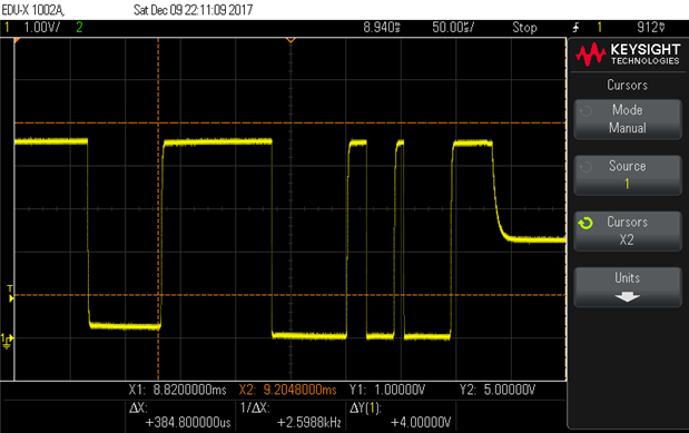

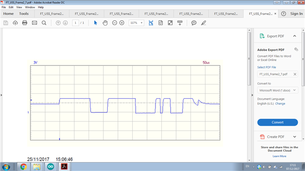

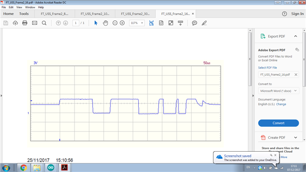

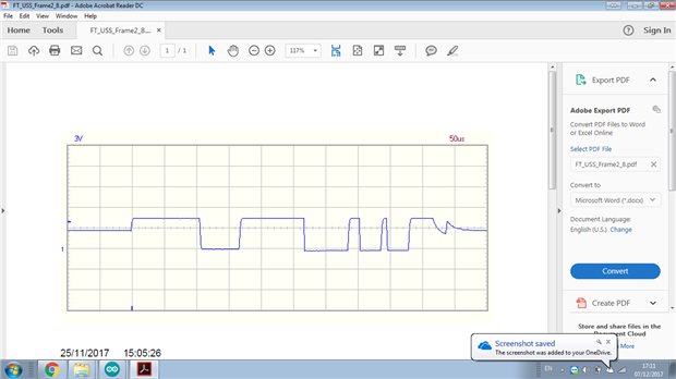

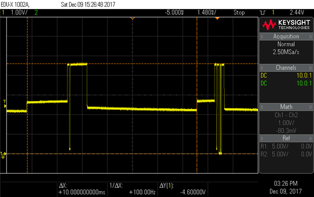

Hello!
I'm having a bit of trouble interfacing the Arduino with the Ultrasonic Sensor from Fichertechnik
https://content.ugfischer.com/cbfiles/fischer/Zulassungen/ft/133009-Ultrasonic-distance-sensor.pdf
Does anyone have any idea of how I could make it work?
This is the code I have so far and what I got from the oscilloscope

    Hi Brandon,
    Please could you use the editor tools to share the oscilloscope image (with the Google drive link we have to share information before we can access it, which I at least am not comfortable with and others may or may not feel the same).
    The question I had was, how are you handling the same-wire for transmitting the low pulse, and the received data?
    One easy method could be to use a transistor (as open drain or open collector) to pull the line low, although software-only methods are possible too.
  • brv64
    0 brv64 over 8 years ago in reply to shabaz
    It's ok, I understand.
    I added the images on the post.
    I got those images by connecting the probe directly into a TXT controller and the sensor.
    If you need more images or information, please let me know

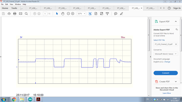

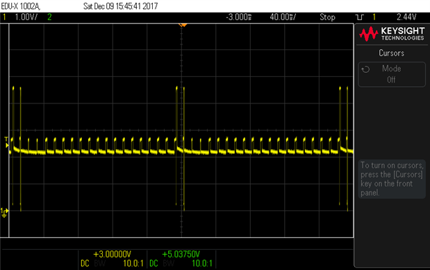

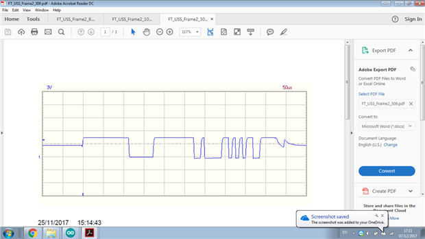

    0 beacon_dave over 8 years ago in reply to shabaz

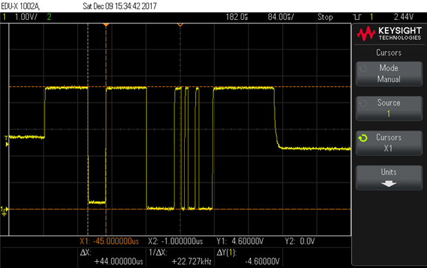

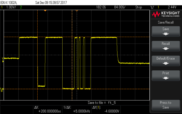

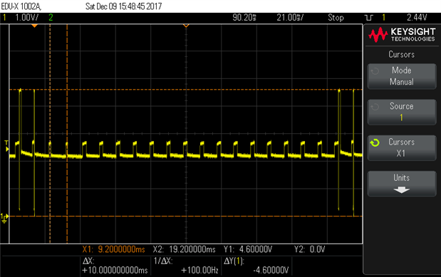

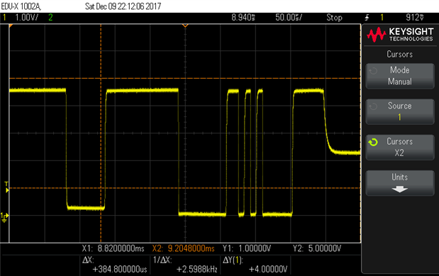

    Hi Shabaz - here is what I see on the scope with a FT Robotics TXT controller and the FT ultrasonic sensor.
    It doesn't appear to quite match the documentation...

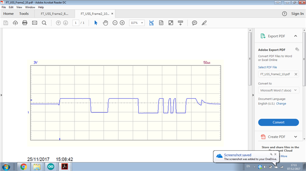

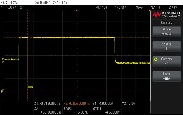

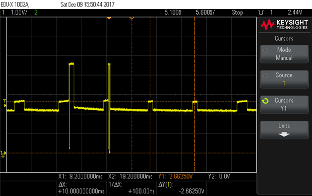

  • beacon_dave
    0 beacon_dave over 8 years ago in reply to beacon_dave

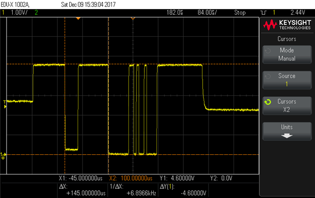

    I had another look at this and it is starting to make sense now. The timings appear to be a bit out compared to the documentation though.
    This screenshot shows two 'host queries'. The first query doesn't get a response from the sensor (not mandatory) but presumably causes an ultrasonic 'TX Burst' at the sensor. The second around 10ms later, with the 'RX Response' data supplied in two bytes, high first, then the low.

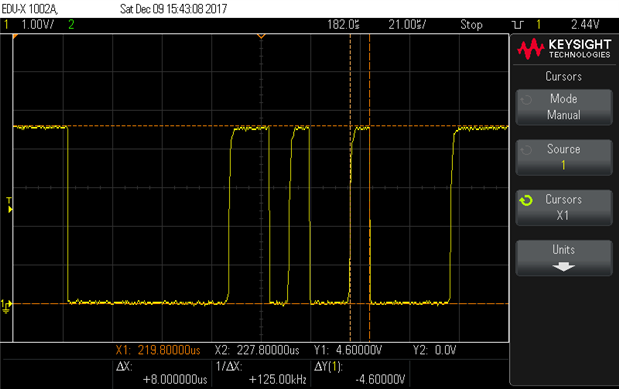

    This screenshot shows the second 'Host Query' in more detail. The low pulse from the controller is around 44us rather than the documented 78us. The '2-Byte answer' is a bit quicker than the documented 0.2ms - 1ms. The high byte shows a value of 0x80 with only bit D7 set indicating it is the 'first byte'. The low byte shows a value of 0x09 with only bits D0 and D3 set. This distance value corresponds with the value displayed in the control software.
    • Reject Answer

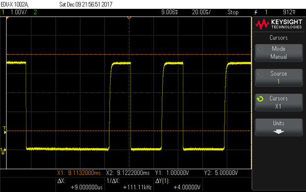

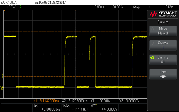

  • beacon_dave

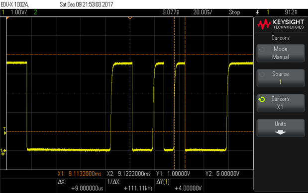

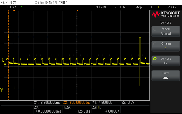

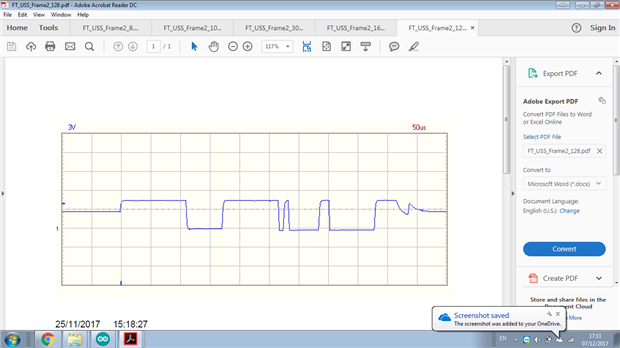

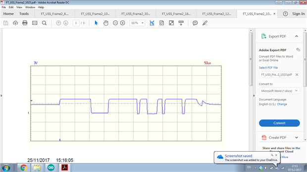

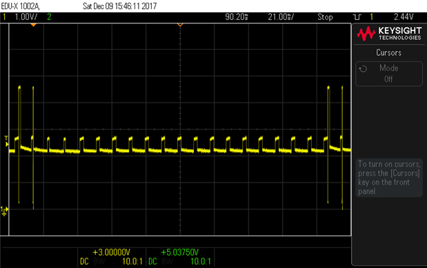

    It's been a slow day so just posting a few more oscilloscope screenshots I grabbed whilst looking at this sensor set-up yesterday evening.
    The high byte can be seen on the left side which remains at value 0x80 for all these captures. Top bit is set which indicates that it is the 'first byte'.
    This one shows a value of '10' being received. Bits D1 and D3 set in the low byte. Cursors on bit D3 show a bit timing value of around 9us which appears consistent with 115kbaud.
    I should have turned the cursors off at this stage for clarity (or set up my triggering correctly rather than being lazy and relying on digital storage image ) but I wasn't intending on posting them here until now.
    Value of '11' being received. Bits D0, D1 & D3 set in the low byte.
    Value of '12' being received. bits D2 & D3 set in the low byte.
    Value of '2' being received. Bit D1 set in the low byte.
    For some reason 2 was the smallest distance range I could make the sensor detect with my test setup. Should go down to 0 (distance <4cm)
    I was able to get a max value of 1023 (distance >400cm) however. With hindsight I should perhaps of captured this end to demonstrate bits D8 and D9 being set in the high byte.
    Timebase changed from 20us/div to 50us/div for the last three screenshots to include the 'host query' low pulse in the capture.
    Value of '3' being received. Bits D0 & D1 set in the low byte.
    Value of '4' being received. Bit D2 set in the low byte.
    Value of '5' being received. Bits D0 & D2 set in the low byte.

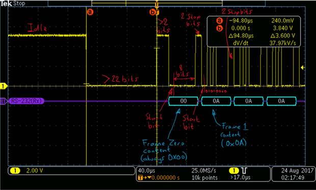

    0 shabaz over 8 years ago in reply to beacon_dave
    I've tried manually writing on traces (using digital pen):
    But in the end it seemed a bit ugly (my handwriting isn't great!) so I just used lines/text as usual:
    I suppose what could be done is pull the trace content as a file (most oscilloscopes will allow that) and then use filtering and line-fitting techniques to automatically clean it up. It might actually not be that hard. Could be an interesting project : )
    As a next level it would be very neat if it could detect popular shapes (like sine waves, charge/discharge curves etc) and automatically fit a line (especially if it could be manually tidied up later too, if the user observed that an important part of the trace was accidentally filtered out by the line-fitting algorithm).
