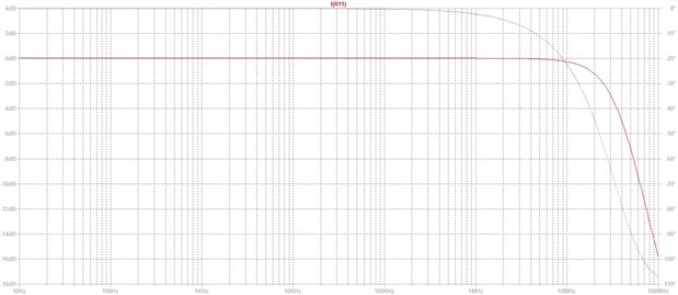

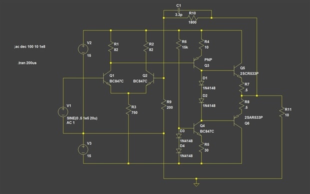

    Here's a really quick and dirty 10MHz audio amp:
    It's a rather evil circuit because:
    1) several of the semis are operating at the max power they can stand with 10V pk-pk output
    2) The output devices are no longer recommended for new designs by Rohm (but they were in LTSpice so quick to use)
    The input pair runs at 10mA per transistor, 20mA down Q3 and Q4 (ie 300mW quiescent - good job it's only a model)
    The output devices are only rated for 2W and that isn't enough.
    However, the approach looks viable.
    I'll locate some more suitable parts and spice models and see how it looks. Layout will matter, the response peaks horribly without the 3.3pF cap.
    MK
