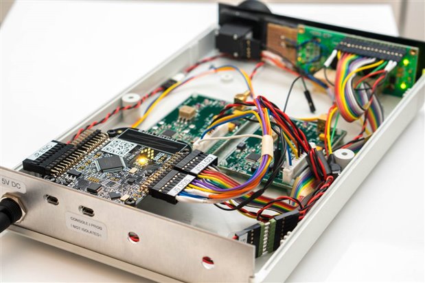

    Another way to solve the physical issue of attaching more than two connections together, is to assemble some cables to attach to the shields (i.e. do not plug them on the Arduino directly).
    Here's one example in the photo below (this is not using an Arduino, but it's the same principle). The photo below shows an Arduino-like board (black, bottom-left) but other boards are not plugged on top. Instead, cables are used to connect to the green boards in the photo.

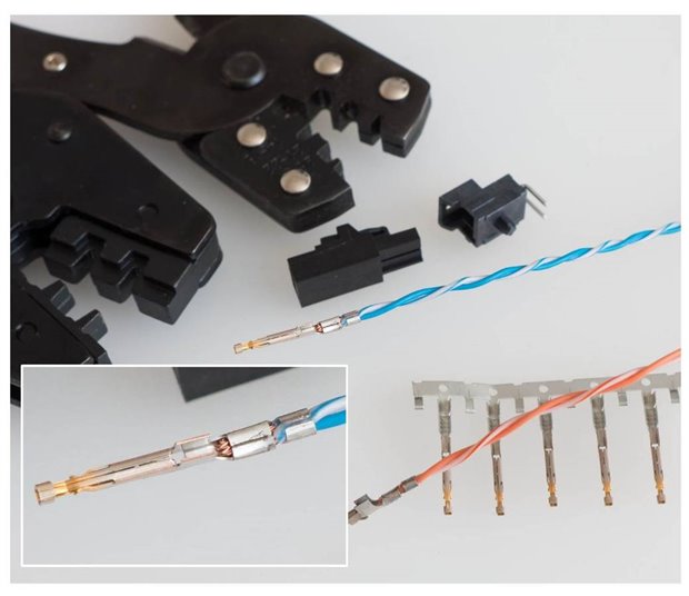

    To make the cables, you need thin wire (e.g. 10/0.1 wire), 0.1" header pin crimp sockets0.1" header pin crimp sockets, and a crimping toolcrimping tool. Plastic shellsPlastic shells are also available.
    You'll still need to make sure there are no clashes. If you run out of useful Arduino Uno pins then you may need a different Arduino, or consider different ways (e.g. using a port expander chip (google will provide more information on this, and your code will need to change if you use it).
    Here is a closeup of what the tool does (this is not the same crimp socket as the one linked above, but similar). The photo shows two wires into the same crimp socket (stripped cat-5 cable!).

    0 shabaz over 7 years ago in reply to Andrew J
    Hi Andrew,
    If you've got ready-made dupont wires, that would work. Optionally, if you wanted to, you could buy the type of plastic shells linked earlier, and they have a tab, so you can remove the single plastic shells on your dupont wires, and insert into (say) a 8-way or 10-way shell. It's not essential, but handy sometimes. The crimp tool is cheap ($36USD/£20GBP+VAT), so longer term you might want to buy that anyway, to roll your own custom-length cables.
