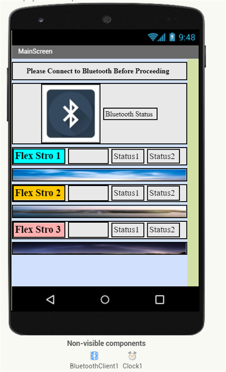

    Besides that, here is the User Interface for the App that I built.
    When the magnetic door switch formed a closed circuit, 1. I want "Status 2" of "Flex Stro 1" to display "Unavailable"
    When the magnetic door switch formed an open circuit, 0. I want "Status 1" of "Flex Stro 1" to display "Available"
    I am just unsure whether I have done it correctly and I have not tried this whole thing yet. But there is something inside me which tells me that it is wrong so yea.
    It would be nice if someone can help me out image

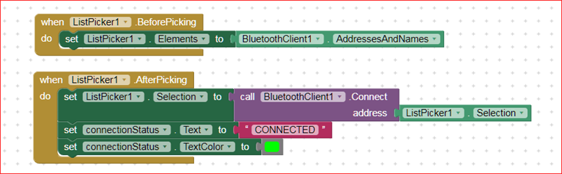

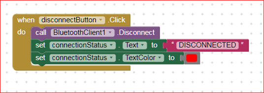

    Looking at your Arduino code, I can see that you are intending to connect the HC-05 Bluetooth module directly to the hardware Rx and Tx of the Arduino. Whilst this will work, it can be unreliable. It's much more reliable to use another pair of digital pins to communicate with your Bluetooth device. Have a look here at my blog:
    https://www.element14.com/community/people/neilk/blog/2018/02/14/mit-appinventor-and-arduino-much-improved-method-of-sending-data-from-arduino-and-receiving-on-android-device
    I have used HC-06, but it will also work with HC-05 - HC-06 is a slave only device. HC-05 can be programmed as a master or slave device. I think you could actually use HC-06 in your application.
    Your MIT AppInventor blocks don't include all that I have found necessary to connect to a Bluetooth device and don't contain any blocks to disconnect from the Bluetooth device.
    I always use a connection structure similar to this:
    And I also include a disconnection block:
    The rest of your blocks look OK, superficially, but I would always develop something as complex as this in small steps, testing each step as I go along. If you take this approach, you will be able to debug your project as you go along.

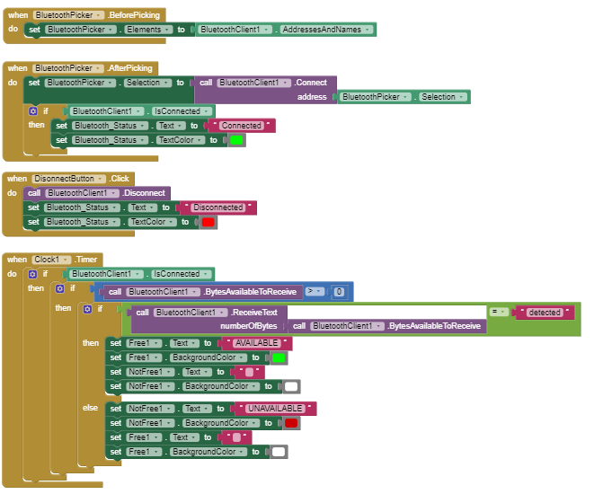

    In terms of programming block, here is my programming block which I have modified according to your suggestion which is really makes sense:
    And the programming code for the Arduino is below:

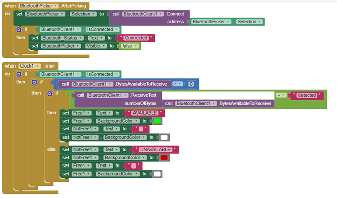

    In terms of programming block I used in MIT App Inventor:

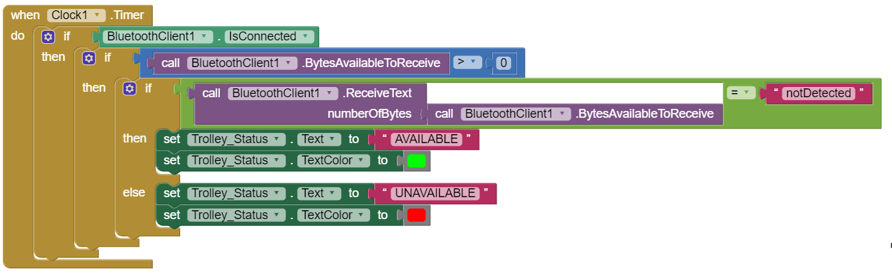

    However, now that you have a connection, you have been able to supply some information that shows up several problems:
    1. The Arduino code you posted your reply of November 13 has the Reed Switch connected to Arduino Pin 4; in your most recent reply, you say it is connected to pin 2
    2. Your Arduino code uses Serial.print to send either "detected" or "notDetected" to both the IDE serial monitor and the HC-05, simultaneously. You need to include a delimiter., otherwise the AppInventor Bluetooth block will almost certainly get confused! The AppInventor  block expects a default of Cr/Lf, so you should use Serial.println instead.
    3. You are checking the Reed Switch every 100 mS - delay(100); What time have you set the AppInventor Clock1 block to fire at? The default is 1 second, if you haven't changed it, then your AppInventor Bluetooth buffer will be flooded. You need to fire the AppInventor Clock1 slightly faster than the Arduino Loop - say 90 mS, to ensure that you read each message from the Arduino as soon as it is sent
    4. In AppInventor, you only check for "notDetected" and assume that if you didn't receive "notDetected", then you must have received "detected". In fact the way things are set up, you are receiving an almost continuous stream of text, containing no delimiters. What you actually read in AppInventor is a matter of luck!
    5. I'm pretty sure your Clock1 block could be simplified:  The second If: image
              Is almost certainly redundant and may well be contributing to your problem

    Hi Neil, I am deeply sorry for the late reply again because I have been busy with examinations lately as I am still a student.
    I would like to reply to your bullet points.
    1. Initially, it was connected to pin 4 because I have connected pin 2 and 3 to LEDs just to check whether my Door Magnetic Switch is working perfectly by looking at the LED. When Door Magnetic Switch forms a closed circuit, LED connected to pin 3 will light up and when it forms an open circuit, LED connected to pin 2 will light up.
    2. I understand about this statement but I am still quite unsure on how to use a delimiter in Arduino IDE. I have been trying to research for some resources also but I did not find anything useful at all. Correct me if I am wrong, based on my past researches delimiter is basically to split a string or character?
    3. The delay I set in Arduino IDE was 100ms and just now I checked the MIT App Inventor for my clock interval it was measuring at 10ms. Do you think this might contribute the instability issue which I have currently?
    Just to keep everyone on the same page. The current problem I have right now is that in the Mobile Application which I built using MIT App Inventor it does not show stable results from Arduino Uno using HC05 Bluetooth Connection. I want the App to work under these two conditions:
    Condition 1: When Door Magnetic Switch forms a closed circuit (1), I want the App to display "Available"
    Condition 2: When Door Magnetic Switch forms an opened circuit (0), I want the App to display "Occupied"
    As of now, the App can fulfil Condition 2. However, when the Door Magnetic Switch forms a closed circuit (1), the App is unable to display a Fix "Available". It will keep displaying BOTH condition 2 and 1 at the same time when it forms a closed circuit. The app keeps switching its conditions within miliseconds. So it is not fix and stable. What might be the causes of this issue?

    I have also attached a very basic App Inventor app which should read data from the Arduino and display it on the screen of your Android device. You just need to import it into your AppInventor environment. It includes the design and the blocks.
    I say it SHOULD work, because I don't have an HC05 set up available for me to test it on!!
