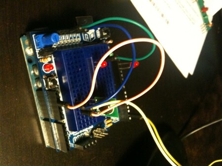

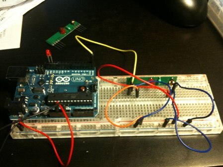

Hi everyone!
I bought my first arduino a month ago, and have been having fun with it. However, last night I was trying to send signals from a TX433 to a RX433 on 2 different unos. First thing to note though is that the TX says it's 433.92MHZ while the RX just says 433 MHZ. I've been trying different configurations and different codes to get them to work but no avail (meaning the serial monitor doesn't show anything at all). Do you think it's because their frequencies are different? (I emailed the store I bought it from , and they insisted that they were compatible, despite that they were from 2 different suppliers). Otherwise, what am I missing? Here are some pics of how I've set them up, and I also posted the code I am trying right now (amongst the other ones I've tried).
Thanks so much guys!

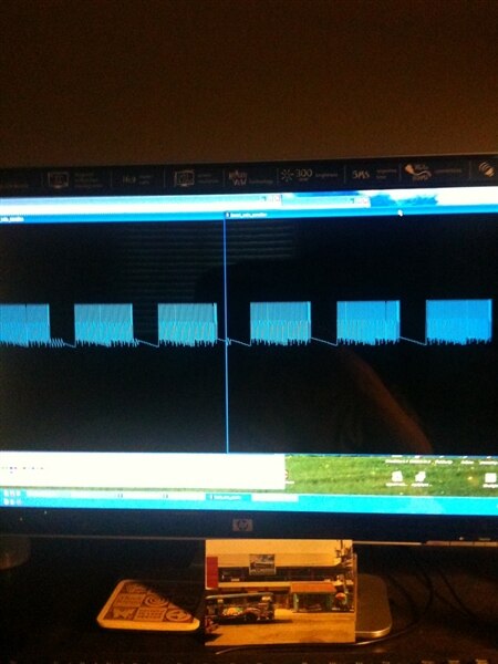

    Thanks for your reply.. I was actually able to make it work.. I used processing to graph the signal using direct wire connection, took a screenshot of it, then I switched to rf and "tuned" the module using a screw driver until the graphs looked the same.. (see pic)
    Please tell me more about the encoder/decoder and how it works as I am a noob to this.. or if you have anyreference you might want to share, that would be helpful. I'm currently using vwire to send stuff to the receiver.
    Thanks!

    AG, that's a innovative way to tuning these units!!!  Can you point to more information on how you did this. How about your Processing code???
    Thanks!
    Regards, Terry King
    ...In The Woods In Vermont
    terry@yourduino.com
    0 e14 Contributor over 15 years ago in reply to terryking
    just set the tx to keep sending the same value (just mod the code above).
    And here's the code I used for processing.. I don't remember where I got it.. But I used it before for building a heartbeat monitor.
