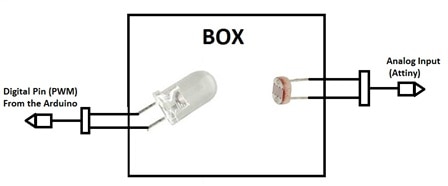

I was wondering how to controll 3 switches with one PWM pin,
what i had in mind was : hooking up the analog pin from the ATtiny to the Digital PWM pin from the arduino, and have a code like this:
if I send ...say 100 to the PWM pin , and i receive that value at the Attiny's analog pin and have it to do this :
If (analogRead == 100){
digitalWrite (Pin6 *from the Attiny* , HIGH)
then i send a 150 from the arduino and have it turn the other switch on , and in theory i should be able to control a few buttons with a single PWM pin from the arduino , is that really possible?

    You won't know for sure till you try it. It makes since that it can be done. But you will need to have the ATtiny look for a range since it may not read the output of the Arduino as 100. You will have to connect everything together and see what the actual value the chip is reading when the arduino sends the signal.
    0 e14 Contributor over 14 years ago
    Possible, yes, but you'll need at least an RC filter. The PWM out is going from 0 to 1 and at any time the input at the next device will be 0 or 1. You need to smooth that to an average value.
    Why not use a serial stream, maybe i2c?
    Or use 2 bits for 4 values?

    That is verry interesting and i will definitely look at it , but with the time i have i wont be able to study it and complete my other project in time ,
    I , however just came up with another simple idea to use one digital PWM pin to send different values to the analog input of the Attiny
    Heres a visual example :
    It wont be with a geat accuracy but i only need 3 values and i think thats achievable
    Plus with this i dont need filters and stuff
    What do you guys think, it has to work.(I am still waiting for the attiny to arrive and i cant test it...)

    The code is much simpler, at least for me, Im not sure what the code will look like for the IR emitter and receiver.And what is the difference?I mean im not fully familiar with the IR stuff

    What I mean is that I can set that LED to a value of 85, 170,255 and the LDR will be set to 3 sectors -the first one - >10 <130; second - >130, <200, 3rd sector- >200, And that will set one of three pins on the ATtiny HIGH.
    Im not familiar with how to set frequency and other stuff on that IR led YET...so i guess that will have to do
