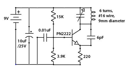

Hi everyone,
now my question isnt arduino related , but i couldnt get the answer somewhere else so i thought that some of you guys might know the answer.
OK so i have a schematic for an FM jammer/transmitter - its both as it jamms the signal by transmitting nothing.
I want to change that nothing to a something (and i know for a fact that its posible with that schematic)So I need to hook up a 3.5mm jack somewhere on that schematic, my gues would be to connect it between the 0.01uF cap and GND , but am I correct? if not do you know where am i supposed to connect it to?
Again sorry that its not arduino related but any help is highly appreciated!

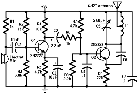

    You will need a little more then that to add audio. Check this out.

    Crap.Ok first is the electret mic like a 3.5 mm jack? I mean can it be replaced with one?
    And this guy made it work with a  schematic using only one transistor and he claims that he used that exact schematic, he just cant remember where he wired the 3.5mm.Are you absolutely positive that it wont be so easy?

    Ok, so i guess i will have to go with the schematic you provided, and again, can i replace the mic witha  3.5mm in that circuit?
    And what are the properties of L1 how many turns ?AWG  diameter?

    Yes the mic can be replaced by a 3.5mm jack or any other audion jack/source you want to use. Use 6 to 8 turns of 22ga wire around a pencile for L1.
