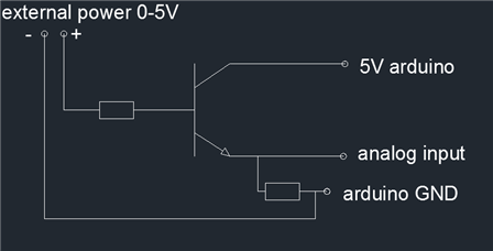

If i were to use a transtor as an analog input device is that the proper way to connect it to the arduino?image
Thanks!
    0 e14 Contributor over 14 years ago
    I think that setup will always read 5V on the analog input. That setup will adjust the current.

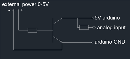

    So what if i wire it like its a button , but instead of connecting it to a Digital pin i use an analog one?

    This latest circuit is a badly implemented common base amplifier - it will have  a low input impedance and very unpredictable gain because the collector load is undefined.
    Tell me what your input signal is and I'll try to help you properly.

    Well all im trying  to do is to have an rc receiver comunicate to the arduino.I think the best way is to use a transistor (the receiver is intended to drive a servo so im going to use the signal wire and the ground wire to drive the transistor)
    if thats not an option i guess i can use optocouplers or something similar
  • michaelkellett
    0 michaelkellett over 14 years ago in reply to dirtdiver
    If it's a standard RC type receiver with a pulse width modulated output you don't need to do it like this - you canuse a digital input and measure the poulse widths. Can you tell me the type and spec of the receiver.
