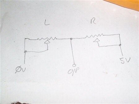

Anyway heres the deal- An rc helicopter remote controller has a potentiometer for roll, pitch and yaw movement
Im interested in the Yaw movement - im building a cockpit and i cant figure out how to split that pot into two pots (yaw is controlled by two pedals in a real heli)
I need to come up with a mechanical or electrical solution...so far i have came up with this idea - there will be a micro switch on each pedal + the pot.
When , say left pedal is pressed the switch bypasses the second pedal's pot and its like its not there and vice versa, but im not sure how reliable would that be

    will there be any sort of mechanical linkage to prevent both pedals being pressed in at once?
    if you did have a see-saw type action then it`s very simple to do, you could even put both pots in parallel, the problem arrises though, when 2 are allowed to travel at the same time, so Left is giving mostly GND and Right is giving mostly +5V for instance, and the middle is effectively shorted out at this point.

  • YT2095
    0 YT2095 over 14 years ago in reply to dirtdiver
    something like this would do it then: image
    but you`de have to arrange it mechanically so that only One can go to the center at any given time, OR either can go Away from the center (probably safest).

    Ok first of all thanks for the help, not everyone will stard drawing and taking pictures and stufs.. image
    and the danger here would be if both pots are set to low resistance? well isnt a single pot doing the same thing when its rotated towards the end feeded with the gnd wire
  • dirtdiver
    0 dirtdiver over 14 years ago in reply to dirtdiver
    but then again that wont affect the resistance between 5v and gnd
    i cant seem to understand the danger here image
    holy *** image am so dumb sometimes... if the first "rotator" bypasses the "resistance"(between theGND and 5 - 10k foe e.g.) of the first pot and the same thing happens to the second pot thats the short circuit..

    Wrong intel image a friend of mine has a flight sim controllers including the rudder pedals, and at his set they are independent - you push one down - the other doesnt move, but after some digging, i found out that ina real heli when you press a pedal the other one comes towards you , so that wont be something i want to avoid anymore image and one pot is all i need
