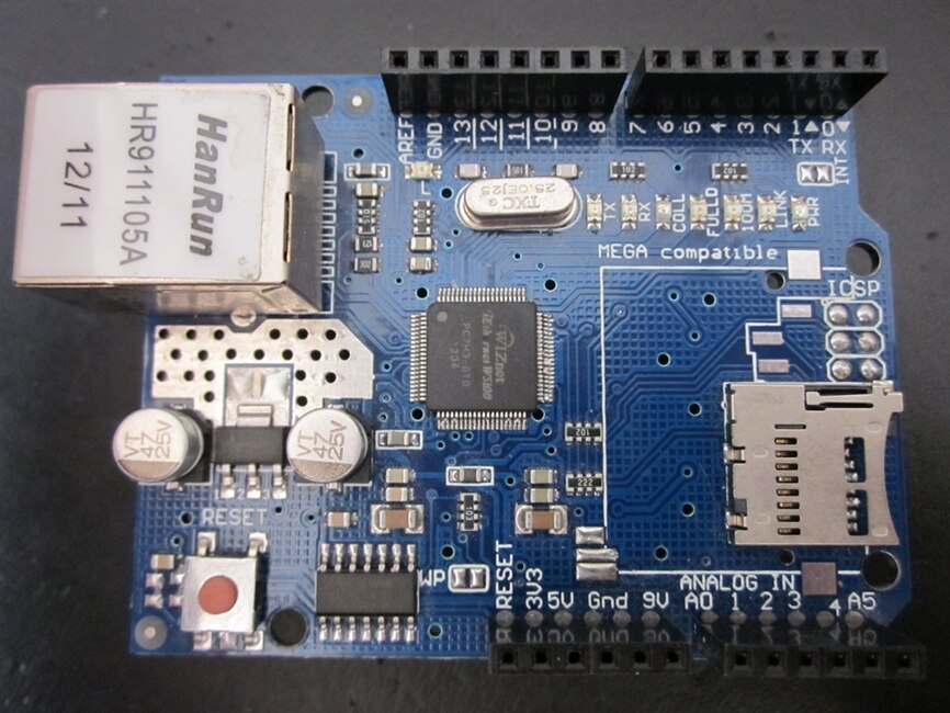

Hi everybody, I desperately need some help on an ethernet card.  The card in question was purchased from Ebay in the UK.  It is undoubtedly of Chinese origin.  It looks exactly like a genuine Arduino R3 ethernet shield apart from the logo's.  I have tried the ethernet shield attached to several different UNO boards, a genine Arduino UNO, a genuine Arduino R3 UNO and a Freeduino V1.16 which I purchased along with the ethernet card from the same supplier.
If I try to load a sketch from the Arduino V1.01 ethernet examples it will load to any of the UNO boards perfectly with no problem, although for the Freeduino you have to select the Duemilanove with 328 instead of UNO board.  When I attach the ethernet board I get the dreaded 'will not sync error'  The sketch compiles but will not load.
A clue was that with the ethernet board attached the LED's on the serial lines did not flash as they do when just loading to the UNO board.  I searched the net and various suggestions included,
bending away the rest pin on the ethernet card - didn't work.
bending away pins 0 and 1 (Tx , Rx) - didn't work.
bending away all the digital and Tx, Rx pins - didn't work.
In the end I connected the UNO to the ethernet card with jumpers just pins 5V, Gnd and 10 to 13 inclusive.  With this set up the sketch will load and if I plug the ethernet card into the router there is network activity.  I then loaded the sketch to automatically find an ip address with the DHCP method from the examples library.  It reports DHCP /ip address not found or not obtainable.  Trouble is I do not know if the minimum connections are OK to enable the shield to work properly or if my router is blocking the DHCP request.

    bobcroft Hi Bob - I've only just seen this - following on from your post re: Arduino Day in Porstsmouth; I live in Sheffield so too far for me as well.
    Any way, did you ever solve this?
    I have a compatible Ethernet shield, also purchased from eBay, and it has worked perfectly from day 1 with both an Arduino genuine R2 and genuine R3
    Does yours look like this?
    Neil

    0 bobcroft over 10 years ago in reply to neilk
    Hi Neil,  actually I live in Bakewell so not too far away from you.  Regarding the Ethernet shield, no I never solved it and yes it did look like the picture you posted.  I bought another couple of shields and they both worked perfectly so I scrapped the faulty one.  It has been a year or two since I posted that enquiry November 2012!
