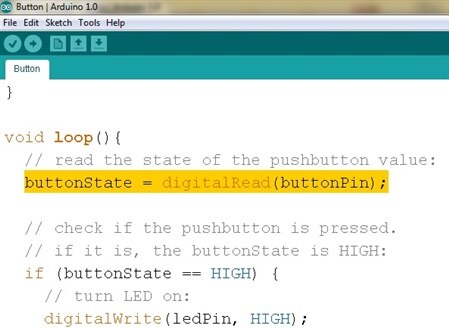

Hi Gurus
I am a first time Arduino user and  have had no experience with code writing at all and have decided to start learning, so this is my first sketch. I want to turn on an LED with the push of a button then delay the LED turning off, I have it functioning but the off delay period is not the same with each release of the button. Due to my lack of knowledge on writing code I need a little help with solving the problem which is driving me mad
I Have attached a copy of my code for you experts to look at (don't laugh)
Any help / guidance would be greatly appreciated
Thanks again
Lincoln

  • billabott
    0 billabott over 13 years ago in reply to e14 Contributor
    No Problem.  The circuit diagram calls for using a pull down resistor.  On rare occassions, it is possible  run into a resistor that has an internal intermittant open.  Otherwise, I don't know without seeing a circuit diagram and checking your physical circuit.
    I suggest that you rewire the circuit using the internal pullup resistor.  This is accomplilshed by pinMode(buttonPin, INPUT_PULLUP).  The physical button then goes between digital pin 2, aka buttonPin, and Ground.  Try them all (the Ground connections) to verify that there is not a fault on the board.  If they all checkout okay, then it was the resistor which needs to have its legs amputated and disposed of in the trash.
    It is good to explore and experiment on your own.  But, you probably should spend some more time completing your basic arduino training with all the sample sketches.
