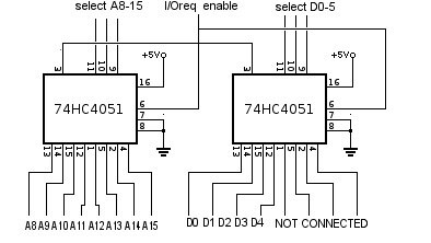

    Update.
    As no one solved this problem I have initiated a project for doing this.
    This project is finally finished: I have now an Arduino Uno with USB Host Shield, the USB Host Library 2.0 (from GitHub) with the example USBHIDBootKbd augmented to translate a pressed key on the USB keyboard into an 8 by 5 bit code.
    I use a digital switch interface, based on two 74HC4051 chips (if you need the design please let me know), to connect the ZX81 A8-A15 address lines to D0-D4 datalines. The Shift key has a A8-D0 bypass using a 4066 chip.
    Arduino uses output 3 ports (A8-A15) + 3 ports (D0-D4) + 1 port (enable) + 1 port (Shift) and works independantly from ZX81 timing. If you need the Arduino code please let me know.
    Regards, Martin

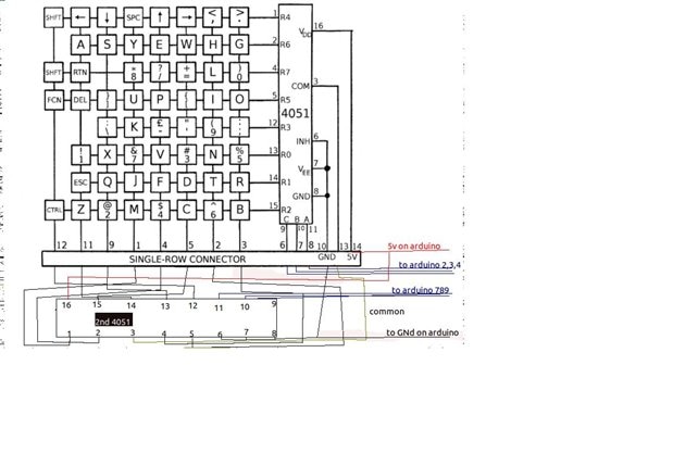

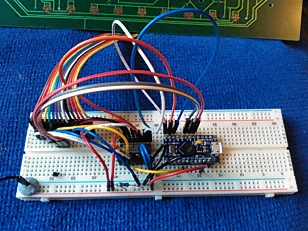

  • robofruit
    0 robofruit over 11 years ago in reply to e14 Contributor
    Hi Martin,image
    I am attempting a similar project with an old 8x8 martix ORIC 1 Keyboard. I am having some difficulty as there is nothing out there for this either. I have managed to get so far (attached schematic). The Oric 1 has a 4051 already on board and I have added another to act as a host for the columns, the one on-board servicing the rows.
    Could you please help me out? I am new to sketch code and could do with some guidance, if you could share your sketch code that would be useful. Am I connecting the 4051's correctly ? (common to common).
    Thanks in advance,
    Alan.image

    0 Robert Peter Oakes over 11 years ago
    The second 4051 is not clear as to its wiring
    it will save you pins and should be easy to drive with 5 pins from the arduino, then 3 more for the original one (Assuming you leave it perminantly enabled)
    the 5 pins (4 is again you leave it permenantly enabled) are assigned as follows
    3 for addressing one of the eight rows
    1 for toggling the line HIGH / LOW
    one optionally to enable the chip
    so code would work as follows
    two loops, 0 - 7 address one inside te other
    Char keypressed = ""
    for each row (0-7)
         for each column (0-7)
              toggle Z input to new 4051
                   if the output Z of original 4051 toggled
                       keypressed  = key (row, Column)
    thats pretty much it, the 4051 is an analogue multiplexer so will do nothing except wire a path between the Z and one of its Y pins so what you have wired is a 1 to 8 multiplexer through the switch matrix then into an 8 - 1 multiplexer allowing you to scan every pin in squence.
    It will not account for multiple key presses at the same time, this takes more code than a simple scan, though you could capture each key into an 8*8 array for the state  but there may be key combinations that would fool the scan into thinking more than the actual number of keys are pressed.. In older keyboards, diodes where often employed to prevent this
    also as the keys not currently being scanned will be floating (Analog switch remember, not a 3-8 line logic level decoder) so I would suggest a pull up on the output of the 4051 your reading from then all keys will read high except the one your addressing.
    come to think of it. if you tie the input Z of the matrix to ground and use a pull up on the ourput Z, then you save a pin and wont need to toggle it. the pin reading 0 if any will be the one pressed
    if you want a logic 1 to mean the key is pressed then use a pull down resistor and tie the input Z to 5V (Not through a resistor)
    Hope this helps
    Peter

    0 e14 Contributor over 10 years ago
    See picture for the 4051 circuit (E is pin3). Using a 4066 for Shift 'bypass' to enable shifted keys (A0 to D0).

    0 e14 Contributor over 10 years ago in reply to robofruit
    Uploaded schematic and sketch.
    0 e14 Contributor over 10 years ago in reply to e14 Contributor
