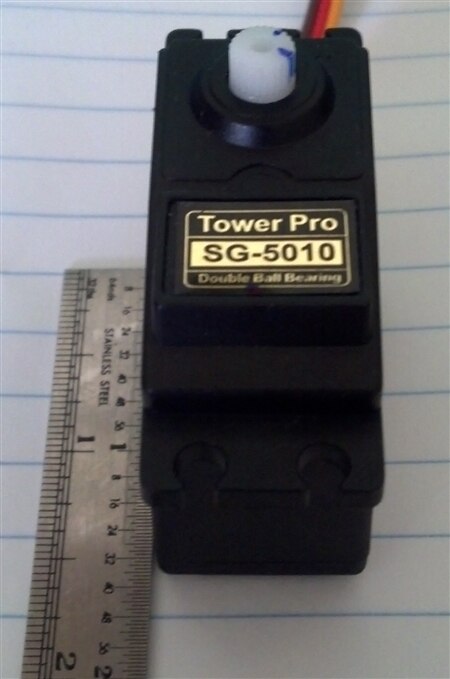

    0 e14 Contributor over 13 years ago in reply to billabott
    In response to billabbott from #5 comment:
    Hi Bill,
    No believe it, it is a linear pot.  Link to the actual ones purchased: http://www.radioshack.com/product/index.jsp?productId=2062354#inTheBox
    The audio’s are: http://www.radioshack.com/product/index.jsp?productId=2062357&filterName=Type&filterValue=Potentiometers
    Although they are identical builds, it is my understanding that the audio board is setup differently.  The board on this one is B10K (see pic below) as per the link you provided http://sound.westhost.com/pots.htm
    Confirmation of the setup is that the UNO anolog pin is 0 (or A0) and is connected to the center pin on the pot (referred to as 2 Sig in attached pic)
    There servo datasheet: is attached as a pdf http://www.kbaam.com/servo/servo.htm
    Attached is an actual pic of the servo sitting on my notebook.
    Tony
