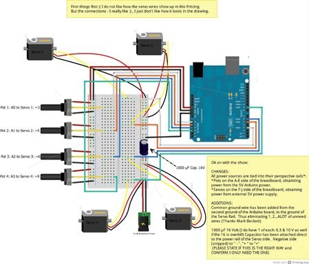

    The suggestions made so far look correct, but I think the issue is in the analogue reading, not the proximity of the output wiring.
    There is one thing that needs to be done.
    The 5v supply unless its a large analogue model with knobs and meters, will be suffering from a lack of decent capacitors.
    Please try to add one or two 1000uF or larger (multiples also work) across the servo 5v supply close to the actual servo.
    Motors draw 3-4 times their running current when starting, and hence your little servos that are 100mA suddenly all turn into 3-400mA devices.
    Coupled with the fact they are all incorrectly driving at the same time, and they all beat each other to death.
    The Arduino reference has mixed messages regarding the name to use for the Analogue inputs.
    A0, 0 all seem to work BUT it has to know its doing an analogue reading.
    It does clearly say to connect the other pins.(as Nico pointed out)
    If the analog input pin is not connected to anything, the value returned by analogRead() will fluctuate based on a number of factors (e.g. the values of the other analog inputs, how close your hand is to the board, etc.).
    Delay
    The examples all use a delay(15) to allow the servo to actually get there, before trying to change where it is.
    This may be enough but will depend on the loading and performance of the servo.
    Annasta
    I suggest trying your single pot on potpin0 (A0) but with the others (potpin1,2,3) shorted to ground (or use a 1k to 10k). This ensures their value is known to be zero.
    I also recommend sending the value to terminal so you can see what is happening.
    I've also added a delay to slow it all down. You need something to allow the servo to get there.
    hence

    To add to answer on analog pin naming. I was curious about this as I knew the A0, A1 ... etc were constants but I had never checked what value they represented.
    Well ...A0 is a constant equating to 14, A1 = 15, A2 = 16 ... and so on but in the analogRead function, A0 and 0 are treated as A0, A1 and 1 as 1, etc
    And on A/D pins
    Unconnected analog inputs tend to track the value on the connected input(s).  This I proved by experimentation by connecting a pot on A0 and leaving the rest unconnected.  The results were:
    A0 = 495
    A1 = 486
    A2 = 476
    A3 = 465
    ... and as I varied the pot and A0 followed steadily, A1,2,3 all followed along, albeit, shifting somewhat randomly around the A0 value.
    This will explain the servos being tied together
    Hope this helps

    I posted a pic of my wiring diagram.
    I have no problem trying out your coding, its an easy change back to the non digital pins if needed; just a question if I may....if I do use the digital pins, all i need to do is change the int potpin numbers, and the myservo.attach(*) to 3, 5, 6, & 9 ?
    I just dont get why these wont work...I am so trying to get this.

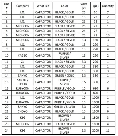

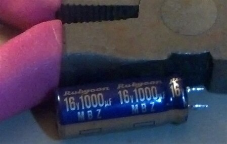

    re capacitors
    The general rule with any power supply is you have 1000uF per amp.
    Assumming your power supply has some capacitors, then 1000uF should help.
    You place them between the 5v of the servo supply and ground as close to the servo as you can.
    You may get a way with 4 x 470uF across the 5v and gnd at each servo, and it will work.
    Do you have access to any capacitors. (They need to be greater than 5volts).?
    Your drawing shows the final configuration with 4 pots installed.
    I don't suppose you've tried it with all 4 connected.?

    @Mark -
    Mark I have approximately 75 capacitors.  Using the line number, can you tell me which ones I can use for optimal performance
    Note I have also attached a pdf file if this list doesnt show up nice.
    ~Anna

    7MICHCONCAPACITORBLACK / SILVER6.31503
    8I.Q.CAPACITORBLACK / GOLD162201
    9I.Q.CAPACITORBLACK / GOLD162204
    10YAGEOCAPACITORPURPLE / SILVER162202
    11ZLCAPACITORBLACK / SILVER6.32201
    12I.Q.CAPACITORBLACK / GOLD163301
    13I.Q.CAPACITORBLACK / GOLD163303
    14SANYOCAPACITORGREEN / GOLD6.33301
    15SANYO / OSCIBCAPACITORPURPLE / SILVER6.53302
    16RUBYCONCAPACITORPURPLE / GOLD106806
    17RUBYCONCAPACITORPURPLE / GOLD6.38201
    18I.Q.CAPACITORBLACK / GOLD1010001
    19RUBYCONCAPACITORPURPLE / GOLD1610002
    20SANYOCAPACITORGREEN / SILVER6.310001
    21CHOYOCAPACITORBLACK / GOLD1015006
    22KZGCAPACITORBROWN / SILVER1618003
    23MICHCONCAPACITORBLACK / SILVER6.318004
    24KZGCAPACITORBROWN / SILVER6.3220011
    0 mcb1 over 12 years ago in reply to Former Member
    Annasta
    A single capacitor from Line 18 down will help when placed across the 5v servo supply.
    BUT
    What happened to the other suggestion and question posed earlier ?
    1.     I suggest trying your single pot on potpin0 (A0) but with the others (potpin1,2,3) shorted to ground (or use a 1k to 10k). This ensures their value is known to be zero.
    2.     I don't suppose you've tried it with all 4 connected.?
    Is there a reason you don't want to try our suggestion.?
