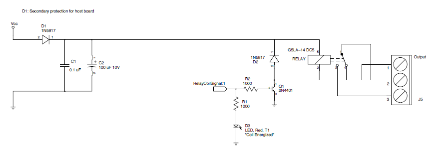

    0 mcb1 over 8 years ago in reply to maranatha
    The schematic for the relay board is here
    http://shop.emscdn.com/catalog/emskits/relayshield/kitv1/G5LA_E.pdf
    The 100uF is not adequate for powering via the USB ...
    BUT you made the statement that you have tried powering the Arduino from an external 7-12v supply.
    The Arduino will switch between USB and external power to whatever has the greater value.
    The external socket goes through a regulator so it needs 7v minimum and the regulator is 500mA on proper Arduino's.
    Some copies may not be supplying 500mA, and if the input voltage is not greater than the regulator dropout (2v) then weird stuff can happen.
    The relay specs are 72mA for the 5v version BUT this is after it has pulled in and is operating.
    It is very likely to draw 2-4 times than amount as it pulls in. ie 288mA
    An Arduino draws 46mA when running.
    So you could experiment by putting a large (more than 1000uF) cap across the Vcc and GND pins of the shield.
    This should help eliminate any voltage sag causing a reset.

  • maranatha
    0 maranatha over 8 years ago in reply to mcb1
    Hi Mark
    I will replace the 100uF. I will rather solder a socket for plugging different capacitor values. Here is my code..
    Thanks
    I presume the RPi detection aspects haven't yet been implemented ...
    You will need to tie the RPi GND and the Arduino GND together if you intend to detect it's state.
    Because the GPIO on the RPi is 3v3 the Arduino can handle it and it will be detected.
    You can simply put the cap onto the pins of the relay shield in the meantime.
    It will be enough to sort out the issue.
