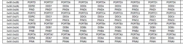

    0 e14 Contributor over 12 years ago in reply to ntewinkel
    Compiling and running are two different things. To compile, the syntax needs to be correct, to run the program needs to do the correct thing.
    For example pinMode(13, OUTPUT) compiles and so does pinMode(PB5,OUTPUT), but the first changes digital output D13 and the second changes digital output D5 (because PB5 = 5);
    The example at http://forum.arduino.cc/index.php?topic=37067.0 is a good example of the use of low level commands. The program write directly to the register and changes the bit.
    Based on the comments by the author, they did this to create a I2C type of signal but the signal required is slightly different from I2C. The reason for low level commands would be timing. Using a digitalWrite command would create a lot of extra lines of code that need to be executed and may not be tolerated in communicating with this device.
    First a few definitions used in the program - mostly from included files.
    #define PORTB _SFR_IO8(0x05) from iom328p.h
    #define _SFR_IO8(io_addr) ((io_addr) + __SFR_OFFSET) --- from sfr_defs.h
         This defines the register's address. __SFR_OFFSET is 0x00 or 0x20 depending on the processor
    In the table below from the Atmega328 processor, you can see that the PORTB register is at address 0x05
    .image
    Now from the code example...
    #define SETSCK1 PORTB |= (1<<PB5)
         1<<PB5 => shift 1 left 5 places => 0010 0000 (space in binary number for ease of reading)
         |= => OR the register PORTB with the bits - sets the 6th bit
    #define SETSCK0 PORTB &= ~(1<<PB5)
        ~(1<<PB5)  => invert the bits => 1101 1111
         &= => and the register PORTB with the bits - clearing the 6th bit
    #define SCKOUTP DDRB |= (1<<DDB5)
         DDRB is the Data Direction Register for port B defined as 0x04. DDB5 = 5.  Setting a bit to a 1 sets the pin to OUTPUT
    Sorry if I vented too much, but hope it was a little educational.
