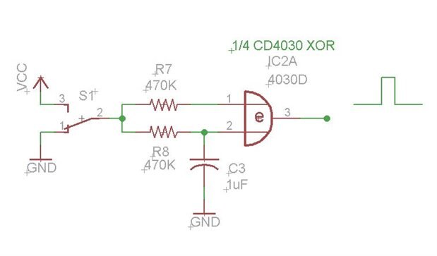

     I would like to build an interface for a flight simulator consisting on various toggle and trigger switches, unfortunately i can't just simply flip a switch to an ON state and leave the signal like that, i need to send a quick pulse every time you toggle the switch ON or OFF, as if you where to push a button on a keyboard to send that command.
     In simple words... i need a toggle switch that will produce one pulse when you flip the toggle switch ON. And a second pulse will be generated when the same toggle switch is flipped to OFF. Here is a GIF to better illustrate that... http://www.desktopaviator.com/Products/Model_2120/2120B.gif
     If there is a simpler way of doing this without using an Arduino, like an IC or a special toggle swich, I would like to know, otherwise, I plan on using an Arduino to do this.

    shabaz over 11 years ago +3 suggested
    Hi Silviu, An easy method to produce pulses is to get a 'quad XOR gate' ic. Connecting one input of a gate to 0V makes a simple buffer which does nothing except delay a signal slightly. Do this with three…

    jw0752 over 11 years ago in reply to silviustro +2 verified
    Hi Silviu; I have drawn a schematic and added some notes. . Don't worry about right answers as everyone contributes good ideas. If you have clarifying questions let me know. John

    0 jw0752 over 11 years ago in reply to silviustro
    Hi Silviu,
    We seem to have sparked a lively discussion. Reference your question about the non-polarized capacitors you can buy them or make them. They are used in audio speaker crossover circuits. I think the Radio Shack used to have them in stock. You can make them by placing two polarized capacitors back to back. For example if you take two 100uf 25 volt electrolytics and connect the negative leads together the two positive leads become 50uf 50 volt non-polarized. You will notice that by connecting the caps in series we produce a new cap with half the capacitance and double the voltage. I would recommend that you use caps that have voltage ratings larger than your working voltage. For example if you are using 35 volts in your circuit then make your non-polarized cap from 50 volt electrolytics. If you are going to use this circuit you will have to use a DPDT switch. I see that there have been some ideas about using center off and momentary toggles. I think you will find that a standard DPDT is cheaper than the specialty momentary switches. These are just general ideas as I do not know much about your application and working parameters.
    Hi Silviu,
    Actually my design is for a standard DPDT toggle switch with only side to side, no center off. I call the one you described DPDTCO. Once the switch is flipped from one side to the other the current flows as it charges the capacitor. Since we are dealing with direct current the flow stops as soon as the capacitor is charged up. The DPDT switch, if flipped to the other side, will reconncect the capacitor to the circuit reversed. This will allow the charge that is in the capacitor to exit and a new reversed charge to flow into it. I think the use of a center off switch would not work as well as the charge would have time to leak out while the switch is in the center position. While you would get a pulse each time you switched from the center position it would only be half the duration of using the switch the way I described it. As far a the actual style of the DPDT switch it can be any kind from a rocker to a slide. One more note, in my original post I mentioned that point "one" could be used to determine the up or down position of the toggle. The sensing of this point must be high impedance or you will be putting a resistance accross the capacitor when the switch is in one position.

    0 billpenner over 11 years ago in reply to silviustro
    adding to the comments by shabaz ;
    The following might of help. Since you are using many switches and apparently need them to be independent,
    you could put all the resistors,capacitors and ICs on a PC board to simplify wiring.
    The ICs are quad XOR gates so each IC will handle four switches.
    The pulse width can be adjusted with R8 and C3. Using the values shown will produce about 1/2 second. The capacitors can be ceramic, which is very small.
    The ICs are available in both the standard dual inline and small form factor.
    I don't know what you are going to drive with the output, so I am not sure if the IC will handle the necessary current.
    Could you let us know where the output of this conversion goes?

    0 silviustro over 11 years ago in reply to jw0752
    Hi, John
    Thank you very much for your answer! it worked wonderfully... not only that, but i tested it using both ON-OFF-ON and ON-ON switches, and they both worked perfectly, there was no voltage leakage. The idea of linking polarized caps together also worked really nice, thanks for the advice.
