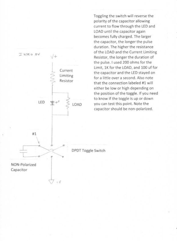

     I would like to build an interface for a flight simulator consisting on various toggle and trigger switches, unfortunately i can't just simply flip a switch to an ON state and leave the signal like that, i need to send a quick pulse every time you toggle the switch ON or OFF, as if you where to push a button on a keyboard to send that command.
     In simple words... i need a toggle switch that will produce one pulse when you flip the toggle switch ON. And a second pulse will be generated when the same toggle switch is flipped to OFF. Here is a GIF to better illustrate that... http://www.desktopaviator.com/Products/Model_2120/2120B.gif
     If there is a simpler way of doing this without using an Arduino, like an IC or a special toggle swich, I would like to know, otherwise, I plan on using an Arduino to do this.
Thank you for your time!

    jw0752 over 12 years ago in reply to silviustro +2 verified
    Hi Silviu; I have drawn a schematic and added some notes. . Don't worry about right answers as everyone contributes good ideas. If you have clarifying questions let me know. John

    0 jw0752 over 12 years ago in reply to silviustro
    Hi Silviu,
    I see that you have marked this question closed but I thought I would throw an old fashioned idea at you anyway. If you are able to use DPDT toggles you could hook them up to reverse the polarity of a capacitor. In this way each time the switch is toggled the capacitor would discharge and recharge creating a current of duration depending on the size of the capacitor. I prototyped a small circuit and was able to get an LED to turn on for one second each time the switch was toggled. If this idea fits your need you could save lots of hardware and programming. If you would like a schematic for the little prototype I put together let me know.
    • Reject Answer
  • silviustro
    0 silviustro over 12 years ago in reply to jw0752
    Hi John,
    Indeed, I am very interested in your prototype, it would fulfill my purposes pretty well. I can always mark your answer as correct, no prob (;
    The less programming and hardware the better, I'll await your response.
    Thank you!
    Hi Silviu;
    Thank you very much for your diagram John, I will sure test it out!
    Now, what do you mean by a NON-Polarized Capacitor? as I have never seen one before, all seem to have a polarization indication on them.
    Thank you.
