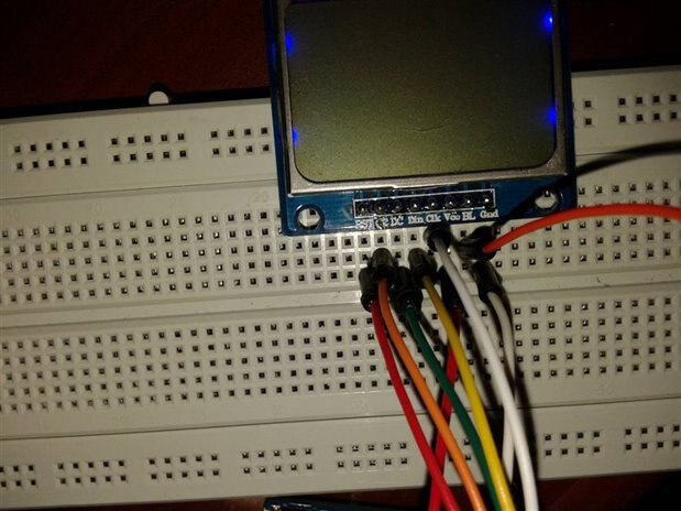

Hello everyone, I'm new in arduino, and i have a project by using nokia lcd 5110 and i bought it yesterday. But when i connect it with my arduino like in this tutorial https://learn.sparkfun.com/tutorials/graphic-lcd-hookup-guide/hardware-assembly--hookup , the backlight is on but the screen is blank(nothing show up in there just a blue color from backlight).         So can you please help me to solve this problem?image
    e14 Contributor over 12 years ago in reply to saurocksall +1
    Ok, these are the pictures, can you please help me?
    e14 Contributor over 11 years ago in reply to mcb1 +1
    Thanks for the tip! there is now a 330 ohm resistor in series with the BL(led) pin. I got this to work in the end by tweaking the bias and contrast settings on the lcd this tutorial: https://www.youtube…

    Post a clearer picture where I can see the LCD and Arduino both, with the jumper wires..
    0 e14 Contributor over 12 years ago in reply to saurocksall
    Ok, these are the pictures, can you please help me?imageimageimage
  • saurocksall
    0 saurocksall over 12 years ago in reply to e14 Contributor
    Hi Bob,
    I don't know if you have noticed it or not but the pin configuration of your LCD and the LCD in the tutorial are different...
    i've searched on the internet and i realize there are so many types of this lcd like in sparkfun product https://www.sparkfun.com/products/10168 and Adafruit product http://www.adafruit.com/products/338 . The different is just in the pin configuration. The configuration i followed from sparkfun tutorial (in the web https://learn.sparkfun.com/tutorials/graphic-lcd-hookup-guide/hardware-assembly--hookup it said that the device have to plug in with resistor and i use different value of the resistor but it still same like before then i tried not to connect it with resistor and the result was still same) and also the code. But after that like i said before the BL(backlight) was turning on and the trouble was just in text or in graphic/bitmap. And i think it's not come from the lcd because i've just bought it yesterday

    i think the LCD it self is defective, try it on another LCD..
    Ok, oh is it necessary to connect the lcd with level shifter ic (5v logic to 3.3v logic) ? i still confuse with this ic
  • saurocksall
    These LCD's do work with 5 volt logic so it should not be necessary, watch the video below it has all information u need...
    Yes i've watch it, but it's still same, just blue screen
