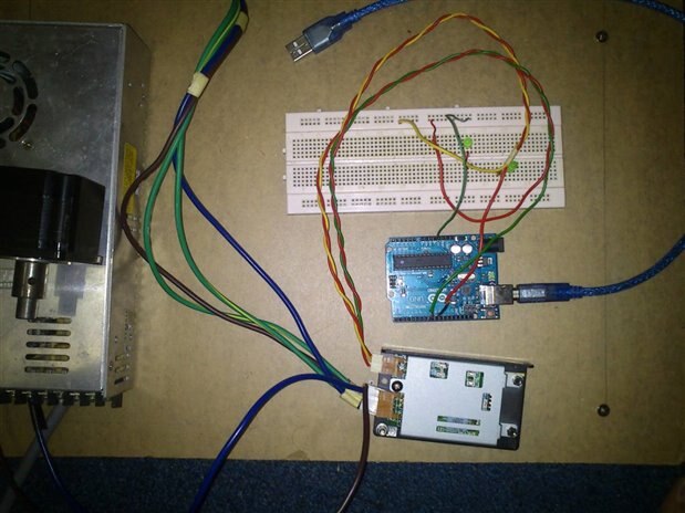

Does somebody can help me connect this driver to arduino unowww.escapmotor.com/MYCOM/pdf/2_phase_stepper/ims200.pdf.....im trying drive 6 wire stepper motor using it and didnt know it wiring connection....here i attach it datasheet

    You can connect it has shown in point 5 (connection diagram), CW+ and CCW+ connected t 5V of the arduino, and CW- and CCW- connected to two different digital outputs of the arduino. But take into account that for this driver, the stepper library for arduino will not work.
    If you need more help with on how to program the arduino to move your stepper motor with this driver, ask.
    By the way, how will you connect the driver with the stepper?
    Regards,
    Miguel
    0 e14 Contributor over 12 years ago in reply to gihu
    thanks gihu.........now i wonder why the motor wont work. i try this simple arduino code and connected it but its not functioning. so if the library for the arduino is not suppport how can i drive this driver ?gihuimage

    You sholud drive pulses directly to the digital outputs
    Try this, not using the library.
    Check that the jumpers in your driver are like this:
    JP1: 1-2
    JP2: 1-2
    code (I could not check errors):

    If it works, we can try to create a new library for your driver from the original Stepper lib.
    hurmm i connected and use your instruction correctly but the motor still wont move
  • gihu
    0 gihu over 12 years ago in reply to e14 Contributor
    Can you check if you have pulses in the digital outputs 8 and 9?
  • gihu
    It seems someone else worked on this.
    Check this library for arduino:
    https://github.com/ronivaldo/Arduino-StepperMSeries
    But it seems to work for pulse/direction mode, not CW/CCW mode, so if you use it don't forget change hardware configuration
    i put an led and it blink....is that mean it got a pulse... i think maybe
    my stepper motor. here i sent it datasheet
    imageAPPENDIX B.docx
    this is the 24v power supply i used
