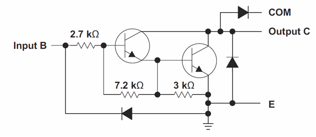

I have been asked to produce an 8x8 matrix for a garden railway signal.
I have written a program for an Arduino to run two 595 shift registers, one running the signal into each row of the matrix and one running the signal into each column.
The matrix works but the overall brightness is poor.
If I just boost the output current I will burn leds out when very few are used.
Is there a way of limiting current when few leds are lit in each row and giving me enough power when I light the whole row?
Thanks.

    is the 8*8 matrix because you want to put different patterns on it
    If that is the case then you may be better of using a scanning process where only one row is ever on at a time, and your current limiting is based on that fact. so typically 20mA at 100% on time per line
    if you then scan through each line quickly (Better than 24 times a second, the eye will not perceive it is scanning and will just appear on.
    because your scanning you will need to increase the current through the LED to say 100mA but this will be averaged out, it may still not last as long as 20mA constant but will be better than the alternatives
    this is a pretty standard technique used across electronics engineering including all those LED clocks we all have image
    the only other way that would be easy would be to wire each LED individually and use 4 16 channel LED chips.
    Oh, there is one other way if your budget allows, LED's will be about 25c each though and that is to use the WS2811 or WS2812B leds, only one wire control's up to a thousand LED's and you can have them any color you want and any intensity as you can control the red, green and blue independently
    look up NEOPIXEL on Ada-fruit
    enjoy the railway

    Thanks Peter,
    The present situation with the shift registers is that one shift register is controlling the X axis and one the Y axis, I energize the X axis at the same time as putting a combination of signals on the Y axis, this lights the LED's in that row. I then energise the next Y axis row and do the same again with the X axis as you are suggesting and I tried to explain in the second line of my first thread
    'I have written a program for an Arduino to run two 595 shift registers, one running the signal into each row of the matrix and one running the signal into each column.'
    Do you think it would be enough to put a transistor on each of the X axis wires to increase the current and if so do you have any idea of the values for a circuit of this type?

    Well to start with, the current for an LED will need to be about 160mA (8*20mA) to get an average of 20mA, this is way more than most chips can handle on their own, especially if your turning on upto 8 in a row (8*160mA = 1.2A)
    For the low side  (Single LED driver) use one of these  ULN2803A - STMICROELECTRONICS ULN2803A - DARLINGTON TRANSISTOR ARRAY, NPN, 8, 50V, DIP | Newark element14 Canada
    it will handle 500mA per channel and t has 8 channels, perfect for the low side
    Then for the high side (Row driver), two of these would work MIC2981/82YN - MICREL SEMICONDUCTOR MIC2981/82YN - IC, SOURCE DRIVER ARRAY 8CH 500mA DIP-18 | Newark element14 Canada
    paralleling two channels will give you the ~1amp you need to drive a row (It is close enough). You could solder one literally on top of the other in order to conserve board space image

    the resistor in each row will need to be between 10 and 20ohms depending on the LEDs you use and the LED supply voltage.
    hope that helps, nice thing is there only a few bucks each
