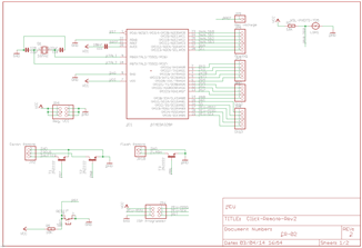

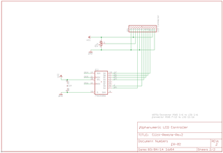

i have used arduino uno to make datalogger for industy.i used sd card,rtc,lcd and some basic ic in my circuit.plz do rply.is it reliable to use arduino in industry?

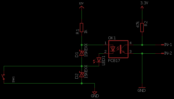

    But, to pursue implementation of a general purpose board a multi-channel Opto isolator board is highly recommended for IOs on the microcontrollers that have sensor input to your environment.
    Like this:
    http://www.ebay.com/itm/8-channel-Opto-Isolator-board-5-24VDC-in-3-3-5VDC-out-Industrial-FRC-Arduino-/131874890430
    or this:
    http://www.ebay.com/itm/311520477631

    0 marek.buriak over 10 years ago in reply to e14 Contributor
    Hello Daren,
    thanks for some useful information. Great to see Due being used in such installations. I am planning on using it for my home automation and I got a few questions if you don't mind answering them.
    1. A switch on a long wire. So let's say you have Due on one side of the room and a switch quite a few meters away. You mention that you usually just use a shielded 24+awg wire. Is that directly connected to Due pin with internal pullup on? I am guessing that normally the line is pulled down to GND (normally closed circuit) and when switch is pressed, circuit opens and the line is pulled up to 3.3V. Is that how you connect it? A long wire can cause significant voltage drop so could not it happen that if the circuit is closed the voltage on input will not drop below the threshold (2V) due to voltage drop on that long wire and the pin will stay high? Also are you not afraid that a voltage spike (I guess it can happen even though the cable is shielded) will damage Due's input pin?I guess I would at least go with something like this at a minimum if connecting directly. But considering optocouplers are much more safe I'll probably go with them for inputs and outputs.
    2. I must say I got a bit lost when reading about different options for powering Due and sensors. So I'll ask this way. What's the best way of powering Due and external sensors from the noise perspective? Is it better to be powered from the same source or from different ones? I am planning on using Mean Well 230V/5V (like PS-05-5 (5W) or PS-15-5 (15W)) to power Due via usb connector. So Due will be powered via on-board 3.3V regulator. Now, some sensors are 3.3V, some are 5V. Considering Due's regulator would probably not be able to power all 3.3V sensors, I guess I need a dedicated regulator for them (a linear one, like AMS1117 3.3V). That should hopefully also help with noise that Due and sensors put back onto their power lines. 5V sensors would be powered directly from the Mean Well supply and I am not really sure about that. Mean Well supply is a switching one (albeit it should be a quality one). I fear that the switched output will cause erratic readings from the 5V sensors. Would I be better off starting with let's say a 7V power supply, feeding that to DC power input of Due (which has it's own 5V switching and 3.3V linear regulator) and also to a 5V linear regulator for powering 5V sensors. Output of that 5V linear regulator would also be used for powering a 3.3V linear regulator for 3.3V sensors. Thoughts? image
    Btw. "Alternatively you can power the Arduino Due directly by feeding the breadboard power regulator output directly to the unregulated 3.3v and 5v pins on the Due.". According to documentation, "Supplying voltage via the 5V or 3.3V pins bypasses the regulator, and can damage your board. We don't advise it.". Just sayin'.
    3. From reading I get you connect Due via Dupont connectors. Do you find it reliable? I mean they must be wobbly at least a bit. The best thing would be to solder the wires directly to Due's pins but it's fiddly and makes Due not really replaceable. So I think the second best thing is to make a shield that uses pin headers. Pins on those are a bit thicker than dupont pins (so hopefully a better connection) and the shield won't wobble (it's also used as a way to connect arduino in products like this).
    Marek
  • michaelkellett
    0 michaelkellett over 10 years ago in reply to marek.buriak
    The solution in your link would not be reliable.
    Typical micro-controller pins require to be pulled down to less than 20% of the supply to register a low input or above 80% to register  a high.
    To achieve this:
    Change the pull up resistor to 10k and keep the input resistor at 1k.
    The 10uF cap across the switch is too large and may shorten the life of the switch (this will depend on the switch of course - if using small pcb button type switches replace it with a 1uF 50V (or greater) ceramic capacitor which can be wired either way round.
    The 20M input resistor is far too big(so the micro pin will be susceptible to interference and leakage currents)  - the diodes will limit the input voltage even under fault conditions to less than 2V above or below the supply rails - you need to limit the current into the micro's input protection diodes to less than 1mA so that 20M could be 2k and you would be no less protected. I would use 10k which means that the micro input 'sees' source resistance of 20k (switch open) and 10.9k (switch closed).
    The ferrite ring is often helpful - put both wires though the same one.
    Although opto-couplers can be helpful the LED in them can still be damaged by transients and might even be energized by RF picked up in long wires. They are much tougher than a typical micro-controller input. The disadvantage is that they need power on the input side and unless you use isolated supplies for this you lose quite  alot of the advantage. For home automation I don't think you need optos.
    MK
    • Reject Answer
  • marek.buriak
    0 marek.buriak over 10 years ago in reply to michaelkellett
    Thanks for your comments Michael. The switch will be a normal wall switch that you use to switch 230V lights in regular home installations (home automation has to be reversible) so I won't be using a capacitor on the switch end. 20M resistor is inside the microcontroller so you can't do much about it image I guess it's just for illustration. I still feel I need to protect Arduino Due as my main controller a bit more, it's always easier to replace an opto than the whole board. I plan on using isolated power supplies, 12V (or 24V) on the switch side, 5V/3.3V on the controller side. I think 3.3V is too low voltage to be used on long wires as a pull-up voltage. Anyhow, I came up with this circuit, feel free to comment on it. I will probably include a ferrite ring as well.
  • michaelkellett
    I would use 4k7 rather than 47k for R2, and make sure the opto-coupler transfer ratio is greater than 20%.
    If D1 and D2 are transient absorber type devices they will be much more effective than normal zener diodes.
    I doubt that the micro really has a 20M resistor inside but as an input the leakage current is quite low.
    MK
  • marek.buriak
    Thanks for your input Michael. D1, D2 were meant to be some Schottky diodes but I can specifically look for transient absorber ones.
