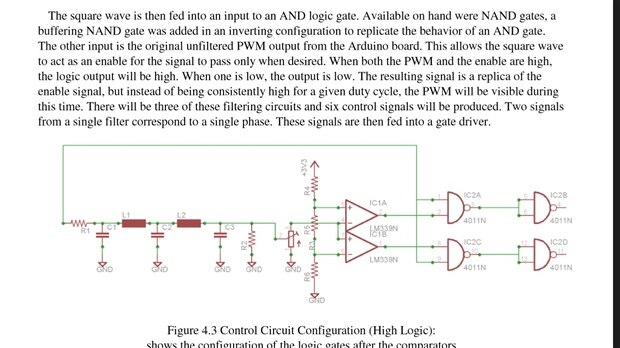

    0 e14 Contributor over 11 years ago
    Hi bro,
    nw i wna to make an inverter , generate spwm by aurdino
    check this site
    Lab3 - Laboratory for Experimental Computer Science
    pwm out put frm aurino fed into low pass filter ,
    in order to make invert pulses
    use comparator.
    output of filter fed into comparator (lm339)
    signal fed into  +ve terminal of 1st cmparator
    and -ve of 2nd comparator.
    the other terminal are connected to the potential dividor ,itz rail voltage is 3.3 v frm aurdino.
    nw u got 2 pulses
    in order to get dample with orginal pulses.
    use AND GATE logic
    OUTPUT frm 1st compartor is fed into 1st input of AND GATE ,other input is orginal spwm pulse frm aurdino..
    if u did nt get AND GATE use 2 NAND GATE for each pulse
    inw u got 2 pulses, if u wan to isolate use optocoupler, then fed into driver (ir2110) ic
