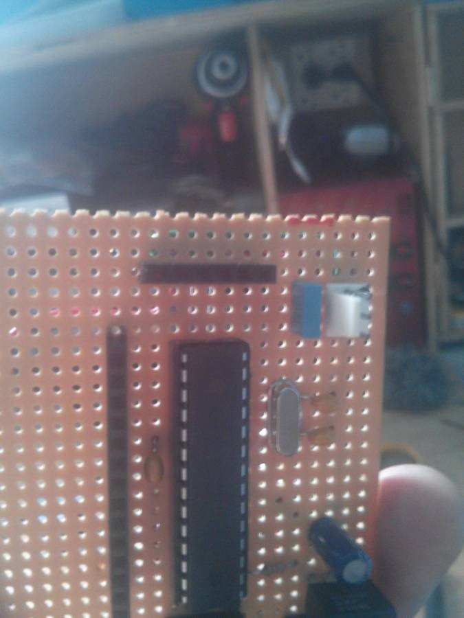

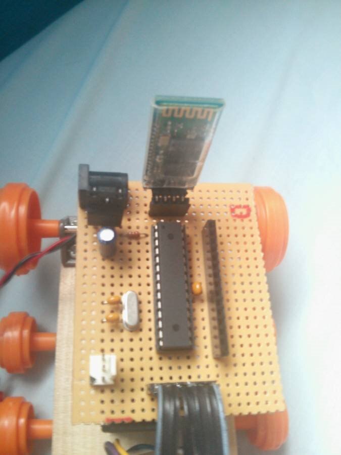

I make an Arduino standalone to drive a simple bluetooth RC Car from my Android phone. Using a
ZITRADES L9110S DC/Stepper Motor Driver Module, a Tamiya double motor gearbox and a HC-06 Bluetooth module.
When I run my code on the Microcontroller eveything works fine, then I plug the Motor Driver  and everything fails.
I need help with this issue? I dont know what's the problem.
I plug just one motor and works, but it doesnt works with the two motors plugged on the Driver Module.

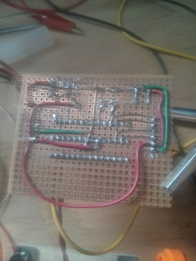

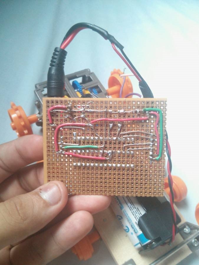

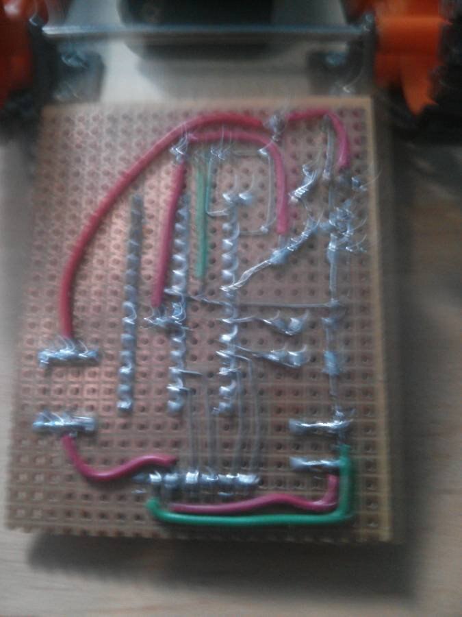

    0 jehielmartinez over 12 years ago
    Thank you for your reply.
    Here's the problem more detalied. Sorry for the crappy solder job. I was soldering and desoldering things trying to fix it
    WHEN I CONNECT  THE MOTOR DRIVER VCC TO THE POSITIVE JOINT ON THE BATTERY PACK WITH A ALLIGATOR CLIP. IT WORKS!!
    THEN I CONNECT THE DRIVER VCC TO POSITIVE 5V ON THE OUTPUT OF THE L7805 WITH AN ALLIGATOR CLIP. IT WORKS!!
    OK! I WILL SOLDER THE DRIVER VCC TO THE OUTPUT OF THE L7805. IT DOESN'T WORK!! image

    0 Robert Peter Oakes over 12 years ago in reply to jehielmartinez
    there is no simple reason the lsat two should not behave the same way
    there is an observation on the routing of your wire though
    in the working version where you connect to the output of the 5V reg will clip, the wires are away from the cpu pins
    in the soldered version your running the power to the driver right over the XTAL pins, dont so that, route the power to the motor away from the CPU pins, especially the oscillator. This may fix your issue , th theory being the noise from the motor is affecting the CPU oscillator
    also add a small value decoupling capacitor at the motor connector end of your pcb maybe 100nF ish, this will help to eliminate the noise feeding back from the motor control
    Worth a shot and fits your symptoms

    I also just realized you seem to be using NMIH Rechargeable batteries, or a version of Rechargeable battery
    These are only 1.2V each and you appear to have only 4 in your holder, this adds up to 4.8V before the regulator, the reg also requires 2V more on the input to get the designated output (5V in this case). This would require nearer 7V from the batteries
    If you can simply try replacing the rechargeable with a fresh set of Alkaline to see if that is all it needs to make things work, re-routing the wire is also still a wise thing to do
    Do you have a meter to validate the voltage coming out of the regulator without the motor running and then with both motors on ?, if so what are the readings

    0 jehielmartinez over 11 years ago
    It works!!
    Thanks for all your help! Now its working fine.
    Here's how I fix it:
    1. Filtering Noise with a 100pF capacitor
    2. Moving vcc source away from the microcontroller.
    3. Four 10 ohms resistors between the Motor Driver vcc and the battery power source.
    4. Replace batteries with 4 AA Alkaline.
    It works perfect. There's just one problem the resistor ladder it's getting very hot. I have to replace them with Mora capable resistor.
